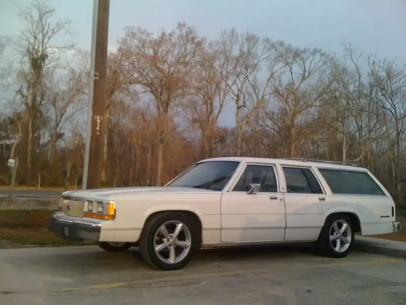

Okay- changed my mind again. Not really changed my mind, but wised up before I went too far. I sold the D60 and the guy who sold me the 38s is buying them back for his new project. I decided I REALLY like where my Explorer is. On 34s it handles as well as most of the Rubicons out there (rich people can't drive for crap) so it's a lot more fun than giving them the excuse of, "Oh, well you have one tons and 38s!"
Besides... I'm building a street/strip cruiser, now. The Explorer will get more upgrades (electric fan, off-road lights, rear bumper) after I buy a house (hopefully) next month, but for now, I'm focusing on the wagon to get it up to par so I can start taking it to the drag strip once in a while.
What do you think? :D
