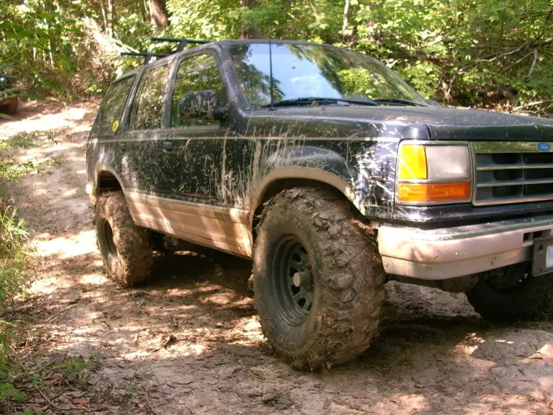

I installed a set of 132X Skyjacker coils, Procomp shocks (up front), and added a Chevy leaf to the rear. I also removed both swaybars completely and threw on my 34x10.50s to see if they'd fit...
They did... but I couldn't turn anywhere...
I cut the crap out of the front fenders. Spent six hours on the passenger's side, twenty minutes on the driver's side once I figured out how much to take out...
I thought things were good, so I took it on its first trail ride... and had a blast!!

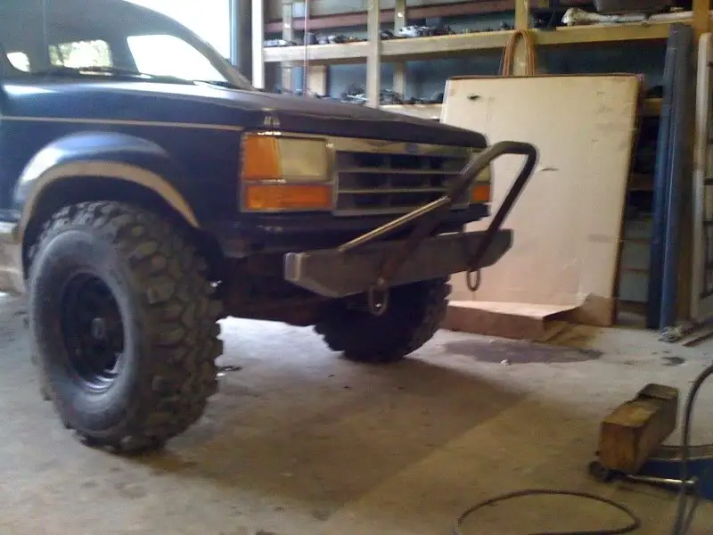

Well, my local 4x4 fabrication shop turned out a bumper for me in two days (he was delayed from starting because he was out of the needed steel) so I could have it ready for a local ride this weekend.
I'll talk to him about regular pricing for a bumper like this if anyone would be interested in one. You guys should check out some of his other work- he fabricates some incredible stuff. www.searchers4wd.com
Here it is just after he finished welding the brackets to the back:

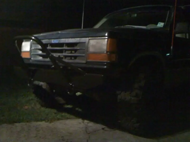

After he went to sleep I hit up Lowe's for some acetone and paint. It was too dark for a good picture, but I'll get some new ones in the daylight this weekend:
