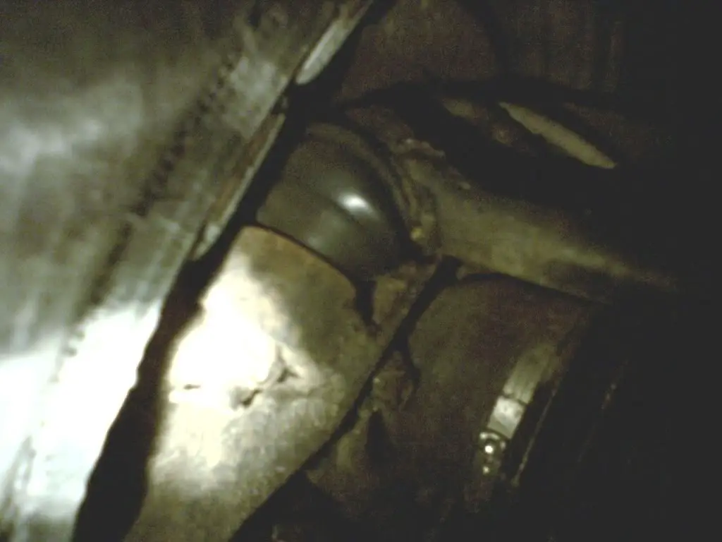

Got some pictures tonight, looks like my *steering knuckle* is rocked backwards a bit, doesn't look good to me, but hopefully I'll get some answers with how this looks, let me know.
Just tried to check the ball joints again. Nothing out of the ordinary as far as play back & forth, I've got a little play in the steering wheel now and it feels like there is some play in the steering wheel and the picture with the hyperextended boot is the tie rod end.

What about my tie rod end being twisted like that, is that normal? I can take more pictures if needed, but I've done all the back yard mechanic tests to see if there is any play in the tire and I've found nothing.
what do you mean "twisted?" you mean rotated foward/backward? that's not unusual, as the TRE needs to be able to have that type of movement.
Yeah, rotated backward, just seems like there's gotta be something I'm missing, but I can't see it. I know there's a clunk and I know I can feel it in the steering wheel.
