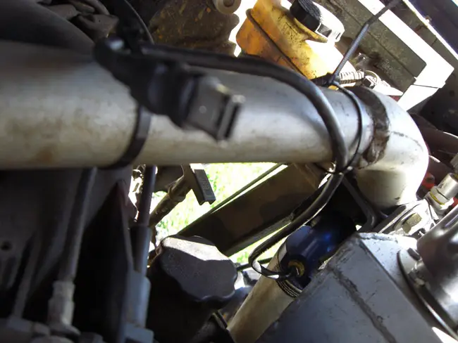

Yuhh -- its a pressure/temp sensor (NPT thread with a built in A/D converter) bored 180 degrees from the fill schrader valve. Sorry for the blur, I dont have any other pic of it.
I was totally making that up, but that's some crazy looking stuff you got going on there. I haven't even touched the valving on mine yet due to the fact that they were arlready run on a truck so I'm going to use that valving and hope it's in my specs.
