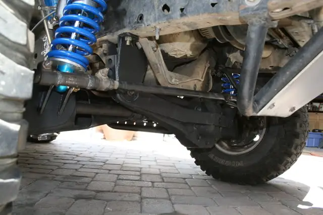

Did you check steering lock to lock with the coilover tabs? I know the steering linkages are gonna be real close. Mine are with the stock linkage and my TRE is under the knuckle.
when i was mocking the tabs up i turned the wheels to full lock. i fogot to take into acount the spring would sit close too. but i think everything clears. my computer is real slow. hopefully i don't fall asleep before photos load.

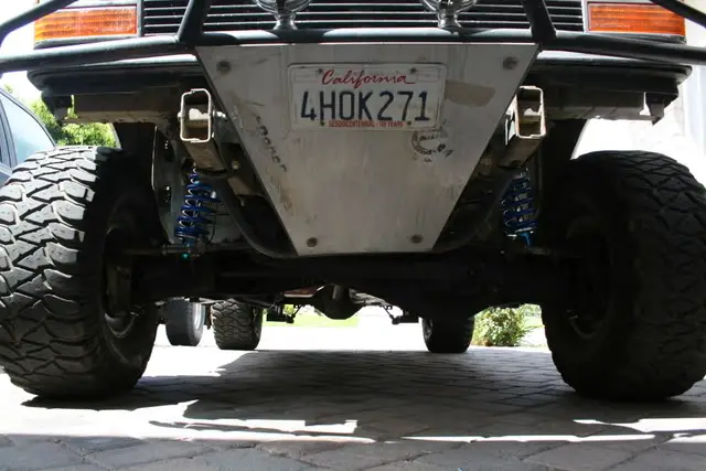

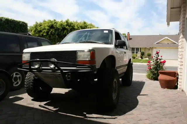

took some pics tonight. i want to adjust the fron end down a little bit. and i don't know if its just the way it is with coilovers or if its cause i dont have nitro in them yet, but driving forward, the front end sits high, and when you reverse, the front dips down really really low and stay there untill you go forward again.
when you pull in forward
when you back in
Daaayyyumm! Looks sweet. That's kinda funny how much it sags when backing up the driveway, looks like a street truck. :) And the back end doesn't seem to sit extremely low compared to the front. And your 33s look teeny under those big fenders now.

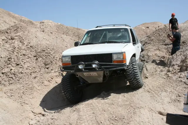

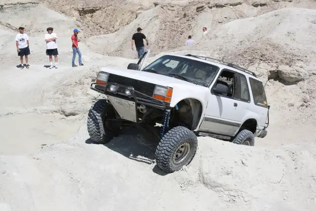

here's a few pics from the trip
do it!!!!!!!!!

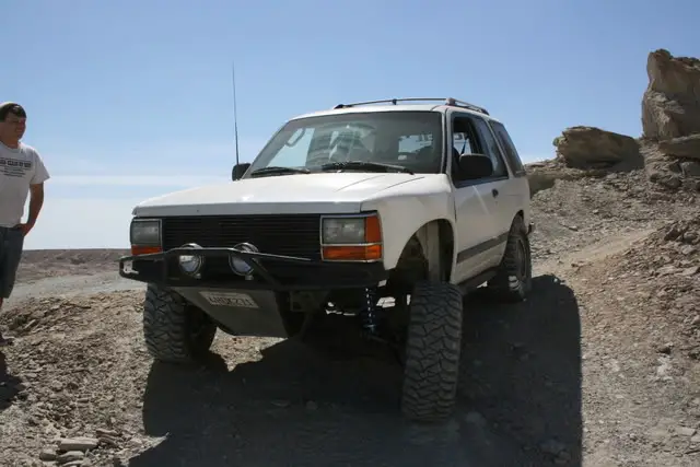

here some pics that aren't action shots and aren't at night.
the axle rubbed juuuuuust a little (see the line on the axle) not bad for all the rompin a did on it :thumbsup:
Are those the superlift springs back on?
EDIT: nevermind, i saw you switched them in your other thread :confused:.
just need set the front about an inch higher and make it level (its leaning to the pass side). other than that the only thing i need to do is twist down the lockrings to adjust when the stiffer spring engages. right now i have it so only the softer, top spring is being used. i'll probably only set it up to use both springs for places like pismo or glamis and just run the soft spring only for rockcrawling.
then all i need is some sweet custome made steering :D i also have a feeling that i'll be going through radius arm bushings a lot.
