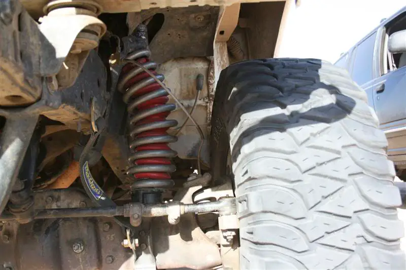

well at the Glamis trip over the weekend, i bent up the coil buckets a bit. so now i need to build some new coil buckeets in this process.
well somewhere between doing this
and this about fifty times
i wound up with this
so im thinking about my options. i could make my own coil buckets, or i could buy this guys buckets for $250 http://www.dezertrangers.com/vb/showthread.php?t=56003&highlight=coil+bucket or i could always get rid of coil buckets and coil springs all together and go the big blingin route :eek:
