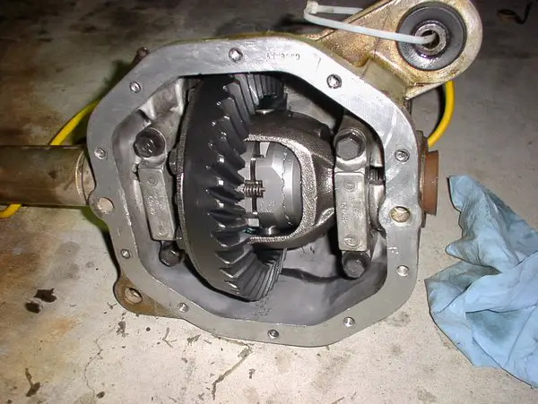

big jim.. there are many of us running the no slip in our front diff. i am one of them. its a "d35" IFS with ABS. no matter how much they tell you they don't make it and never did, i have one! its in there now. it works. nothing didn't work. perfect fit. gerald has one. jobunn has one. there are others that have them! jefe had one. go offroad had one. desert spive had one. those last two ran them in rangers.
we are not confused about having no-slips over lockrites. the two that got lockrites recently were the ones that issues with the install! josh adams is one of them. his works. premier is one of them. his works.
heck here are some pics for you. the first is the day mine came in the mail. the box even says no-slip on it. its got the no-slip part # that i ordered. it looks exactly like the no-slip in the rear just smaller. its a no-slip. the next pic is of the day i cracked open the front diff to install it.
what i'm trying to tell you is.. there is a no-slip for the IFS front end of 95+ explorers and 98+ (or whatever year they switched) rangers. and they WORK!

Howdy Jason

:) You make statements equally as strong as I do.. I MUST believe that you know what you are talkin about.. Damn! Now here I am with a lockright and what I really want is a no-slip.
I am calling richmond right now and I will be back here in a few..

there is nothing that needs clearing up.. they make them! all of the IFS explorers have CVs.. it doesn't matter what year IFS you get. its got CVs. every 4x4 explorer from 95 up has CVs and a "d35".
jim.. no offense, but i don't think you want to believe us. i don't know how many times we can tell you that we have them in our trucks. we didn't all gather up at a machine shop and cut them ourselves. we got them from powertrax because they are the only company that makes them for our application. maybe they are discontinuing them. i don't know.
