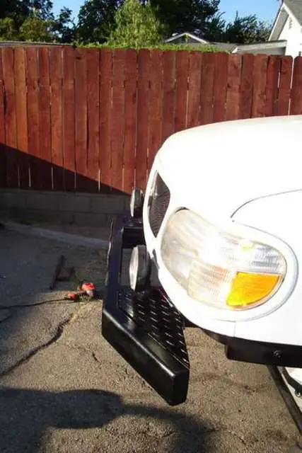

I liked the idea of the sides better ;)
Like mine :D

The main bumper has 2" angle iron welded to it with 1/2" holes drilled in the mount. On the frame, I removed the frame horns and welded 2.5" square tubing on top of the frame rails.. It is welded on both sides plus has plug welds inside the square tubing.
I would try to get pics but unfortunatley with the winch in there, its kind of hard to photo to show everything.
This kind of sums what it looks like.
