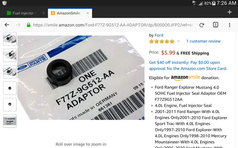

Where fuel injector goes into cylinder head there is a type of plastic adapter, you should replace all 6 as they are probably cracked.
