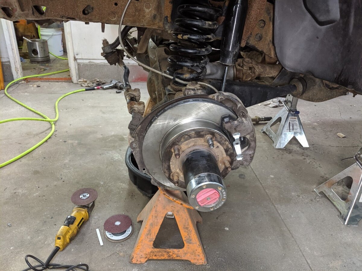

Back in he shop for some winter upgrades, trying not to drive it on winter time salt covered roads! Pictures to follow!
Running 1.25" spacers up front and 1.25" adapters out back. I'm running some 16" Dodge steel wheels with a bit of off set so the wheels should sit in the fender wheels about the same as stock. I'm planning on traveling a lot with this one so I'm trying to keep it so I can source parts fairly easily if needed, wanted to drill the stock axles for screw in studs or buy new axles in 5.5" but the spacers/adapters seemed like the route with less resistance :)

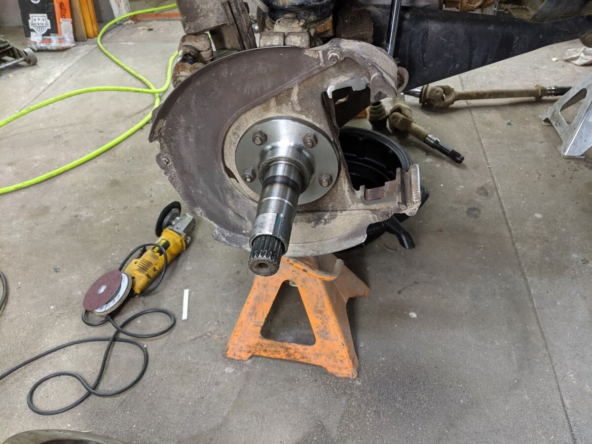

Made a nice clean slate today for the new shock/coil mounts this weekend.

you’ll love the bigger brakes.
Thanks I've run 17" Dodge steel wheel on my Early Bronco's for year I like the looks and the strength of the steelies. Didn't really gain much with the brakes I'm using machined down (1/2" smaller diameter) 94' Bronco rotors on the Dana 35 knuckles.
So you’re using the smaller calipers too.
I went w the D44 knuckles out. The difference in braking is noticeable.
The steelies look nice!!
I would like to have a piston large enough to be a trash can! Look at that sucker!! HUGE, d44 conversion also very nice :)
Yes 94' Bronco rotor/hub, spindle, and stub axle already have disc's in the rear and never plan on anything larger than a 33" tire so I'm happy with the brakes.

Still need to rebuild the shocks but the front is done!
