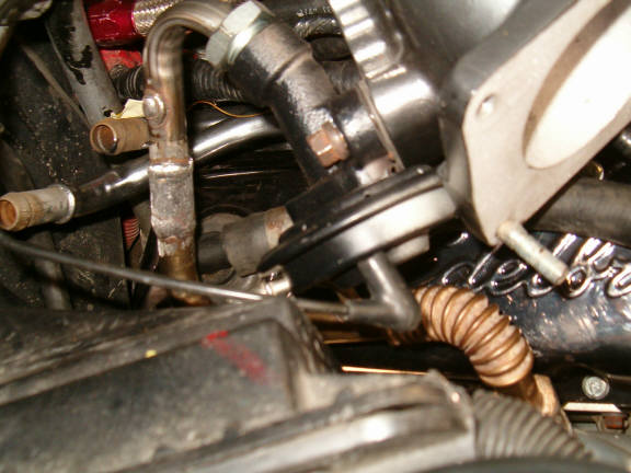

I'm going to try to order my tmh this week too. I havn't been able to sleep haha. I put 1.7 rocker arms on my mountaineer, and its been a nightmare ever since. The driver side valve cover wouldn't clear the 1.7's, then the steel one i found leaked bad. I bought a nice set of a mustang, after pulling the upper intake 7 times, i told myself if something doesn't fit i'm going with the tmh's and 1" spacer. So sure enough they fit but did not clear the egr tube on the passenger side. So i'm ponying up the cash and doing it right..
My home made egr tube

I've got one of those egr valves, where the bung is on the side not the bottom but couldn't figure out how to get it to work.. i'm probably going to have to tweak my egr tube with the tmh's. I was having problems with the tube cracking so i went to ford and they had an updated egr tube for this motor, its basicly the same but its solid, no flexible ribs, and seems slightly thicker. So i gained a tube that wouldn't crack and leak, but now i want the tmh's, i lose the little bit of give i might need.
Ok so i got a hold of Bob yesterday over the phone. Im gonna end up paying just the $689, and he's taking away the shipping fee for me (thanks alot). He's also sending a custom EGR tube in from Ford too. Sounds good.But Im gonna order it next weekend instead and then order the spacer probably 2 weeks later. So Im guess this project is looking like mid- feburary right now which is fine. I still got Tax returns coming in soon too.
Did you tell bob you were going to add the spacer? If not make sure you do, or the egr tube won't fit, we had to modify my stock one and use it instead.
Yes I did because he asked me about whether I was going to order the spacer or not and I said yes.
