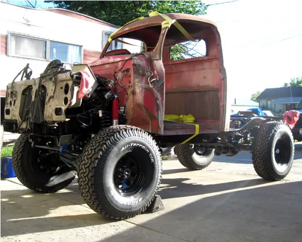

The front end Is all SuperLift's 5.5" lift package with their Super runner steering package. I beefed up all their brackets with gausets or welds where it looked like there would be stress points.
picture.php
I modified the shock mounts using F250 shock towers raising them 8" and Rancho 999036 shocks.
picture.php

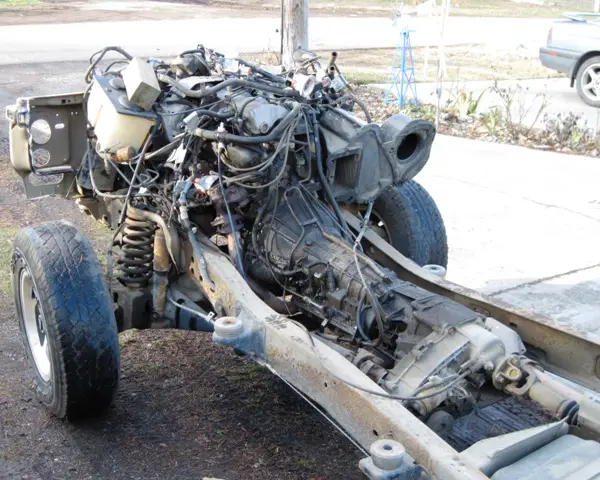

...killer combo. what engine/trans you running? 4.0/a4ld?
Yep, for now, it's just the stock package that is constantly "Marking it's territory". (450K) May change out for an 351W in the future if money allows...

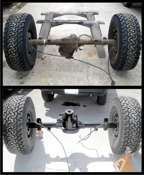

Regardless of who's right, here's the result of last night's efforts...
After everything was removed, I started by taking the grinder, armed with a wire wheel, to the springs. I painted them with epoxy based enamel, replaced the friction pads ($.35 ea.) and lubed them up with Brake lube...

OK, if the sun holds out, this will be dry and hanging under the springs before my GF gets back home...
OBTW, notice the Jeep leaking coolant on the drive? Just started this morning and I chose to spend my day getting the axle ready to go back into the truck...

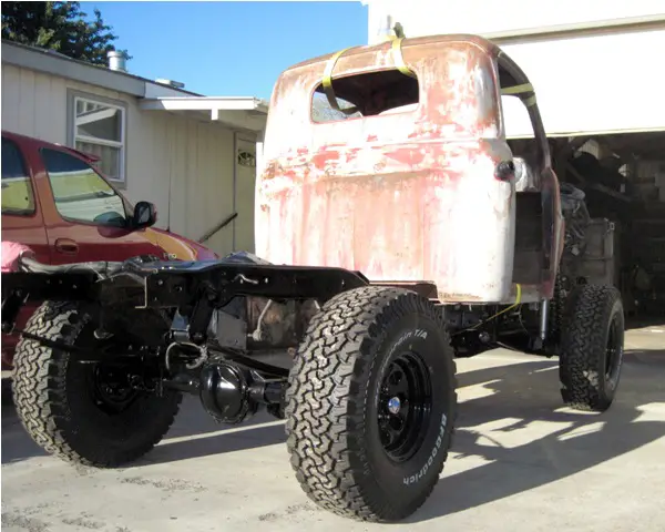

Well, I got the axle bolted on under the springs today. I noticed that the driver side has a couple more inches of sag so new/flexier springs are on the wish list...
Next on the chopping block, I want to install the parts that I have on hand for the wheel bearings and brakes. Then it's on to figure out my shock mounts...
Gotta take a break for a couple days. Mamma has a pretty good Honey-Do List backed up for me. And go figure, the truck's not on it!

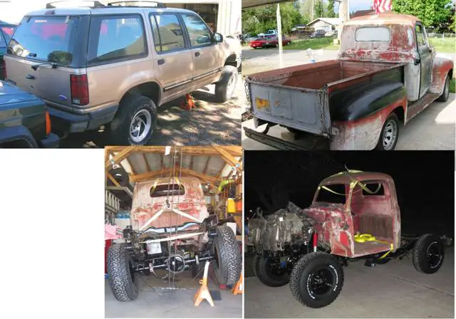

wait a sec, i might be stupid, but is this going to be a explorer or a pick up? is that cab just for mock up?
Hybrid?
I guess it's my version of what a Hybrid should be... That' why I called it "Project Insanity"

Leveled out.
I was afraid that the front springs were so stiff that the SOA wouldn't level it back out. Actually, it looks like it was the perfect amount.
