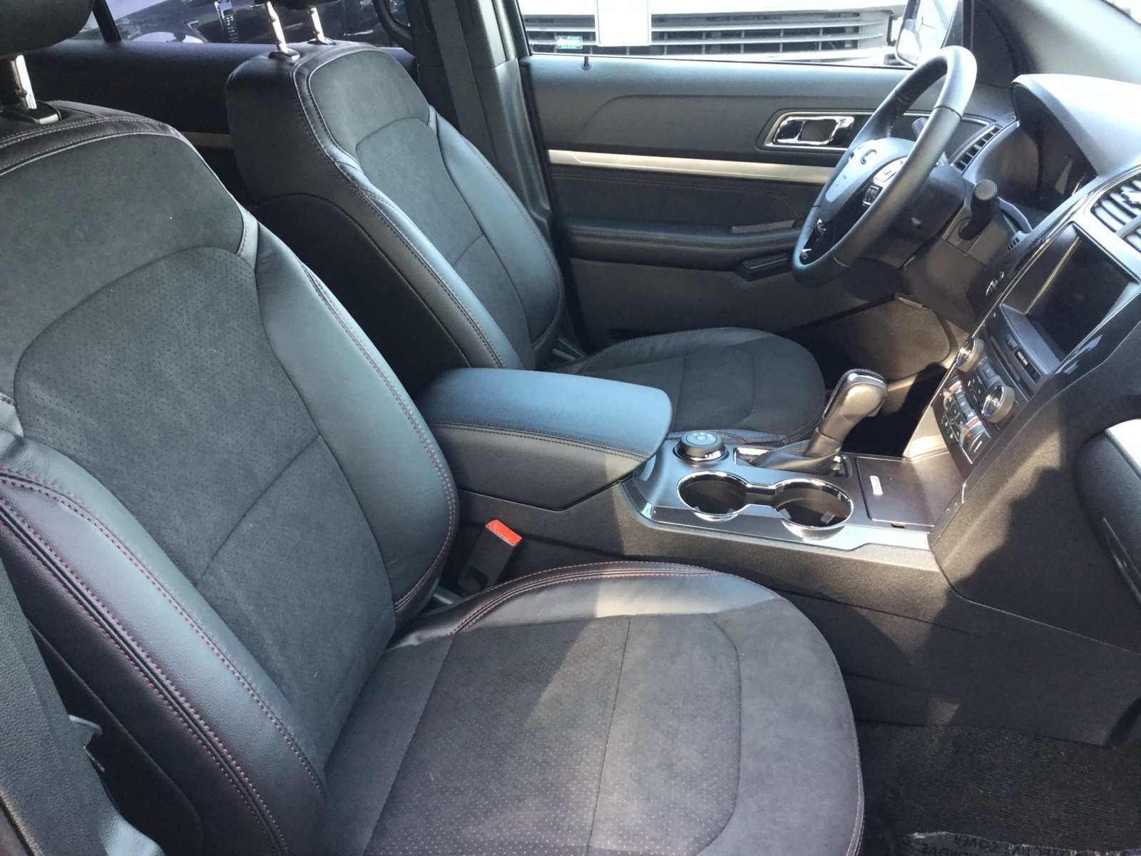

My 2018 XLT with Sport Appearance Package came with the Miko Suede seats.
These seats are awesome, and they get warm immediately. Much nicer than the cheap
leather seats my Flex had. I’m sure they will be cooler in summer too. The steering wheel definitely cycles high to low, but it stays warm until I lower the cabin temp.
