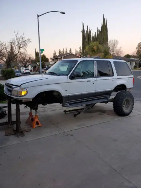

I am currently in the process of stripping my gen 1 explorer and building a gen 2 will have a 79 Dana 44 with chromemolys and a 60 rear.. upgraded the t case to the 4406 manual and am currently trying to figure out what I want to do with my steering.

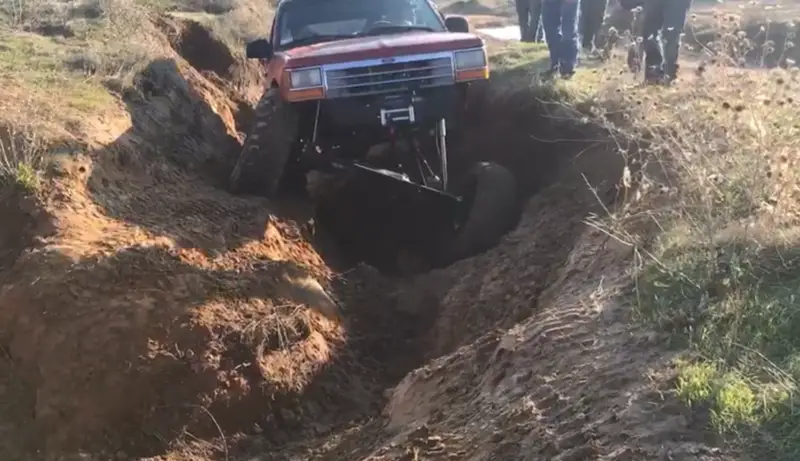

now those are jack stands :)

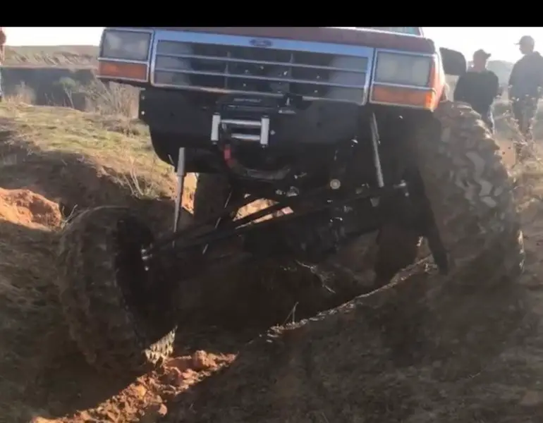

Nice articulation!
more please!
Welcome.
What kind of struts are those?
Not struts. I am running fox nitrogen filled air shocks. I have been on these about 10 years and they work great. These are the 2.0 the 2.5s are sweet just way out of my price range.
So it's coming along. Have the front axle partially mounted. I just got my 4406 manual t case mounted today and started the linkage. I have the plates made for the steering box setup and going to buy the new lower radiator hose so I can relocate my oil filter. This has been a cool little project
