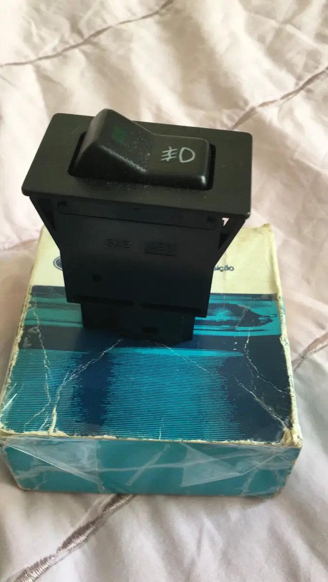

Hello guys! I am installing a OEM Fog Lights Kit on my 93 Explorer. For what I researched, it´s a kit that was available on the Ford dealers, from 1989 to 93. In 94 the Fog lights became factory optional. I´d like to install em as close as I can to the optional 1994 lights (image below). I already have:
1) The E9TZ 15200A KIt that has the fog lights, the relay and external wiring from the relay to the lights.
2) The stock switch (illuminated, the one that came with the kit wasn´t).
I need to find and buy:
1) The brackets (I found the F27J-13A222-DC as being the correct, images below) that go below the bumper, behind the front spoiler.
2) The conector that goes on the stock switch (with 4 wires, blue/red, black, yellow and red/black).
3) The installation instructions for this E9TZ - 15200A lights
Can anyone help me finding those items? Here goes some diagrams that I found online, hope it helps who needs too.
Thanks!

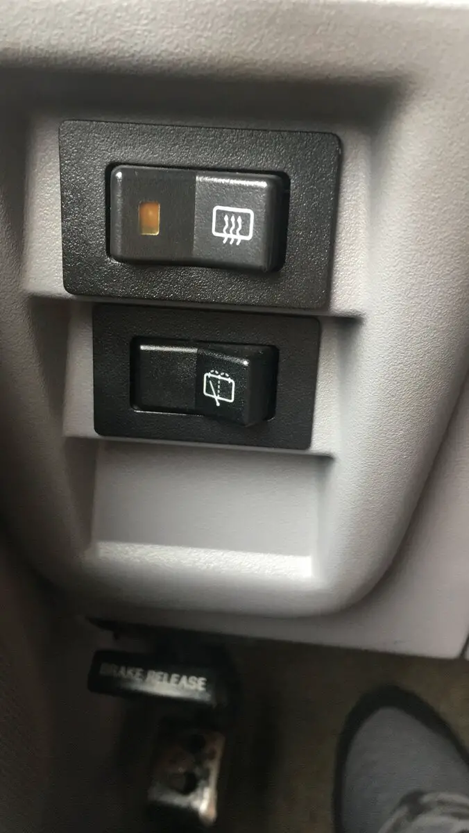

Best bet is to try EBay and keep checking the junk yards. Also try looking on the local for sale/offerup/CL to see if anything comes up and you can ask to buy those parts. I found my brackets at the junkyard (in 2014) and yanked switches out of an EB. Sorry but I sold the other switches. The same switch may have been installed on other fords of the era, like Aerostars and Rangers. I also think the fog brackets were used on the full size trucks. For anyone else interested take note: the fog lamps themselves are the same size as the ones used in ~1995 Pathfinders and ~2000 Xterras. You can save a lot of money buying these lamps instead of looking for an NOS kit that would probably be quite expensive. The brackets, the lamps, a switch and a generic fog lamp kit with fuses, connectors and a relay would be as effective.
I have yet to hook mine up since I’m busy on other items right now, but I’ve installed the lights and brackets and the switch. Here is a thread that I’ve found that I’m going to follow in order to complete my installation.

Thank you very much for your help! I have the fog switch, need the conector that goes behind it. And the brackets. I have the fog light kit but thanks for your tip, if for some reason one of them gets broken, I already know how to replace.
