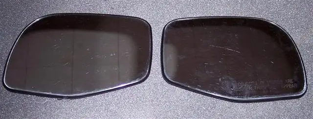

3. Install Signal Mirror to Mirror Housing
3.a. Remove Mirror Glass - Insert large slotted screwdriver into slot on bottom of mirror indicated by red arrow and twist to snap mirror glass off the mounting

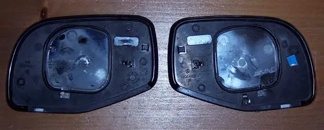

3.b. PASSENGER'S SIDE - Remove Limit Guide & Transfer to Signal Mirror - White arrow points to limit guide on OEM mirror - Red arrow points to slot for limit guide on signal mirror
3.b. DRIVER'S SIDE - Remove Limit Guides & Transfer to Signal Mirror - White arrow points to limit guides on OEM mirror - Red arrow points to slots for limit guides on Signal mirror
3.b. Limit Guides Installed on Both Signal Mirrors

do you know if these mirrors will work for my 2004 ford explorer eddie bauer? I have heated mirrors and was wondering if that will affect it.
I can't say for sure if they will fit the '04. I know that you will lose the heated mirror when installing this kit.
If the mirror glass is the same shape and size, and the mount looks like this, then the kit I got will work:
Hope this helps out. :):thumbsup:

I have a Gen 3 with GEN 4 mirrors. Is this still applicable? Also all your images don't work saying you have reached your bandwidth limit which kinda sucks because I was going to print it out >.<
Sorry about the photos not showing. I have taken care of that and all my photos should be showing on all my posts and threads.
The shape of the 4th gen mirror is different and therefore this kit will not work with the 4th gen mirrors.
4th Gen Mirrors:
photo courtesy of www.mojoparts.com
3rd Gen Mirrors:

I bought signals from IJDMTOY.com however when using heat gun and trying to get glass out gently it broke on the rightside corner. so I gave up just ordered a new heated glass and ordered built in signal ones from Muth
