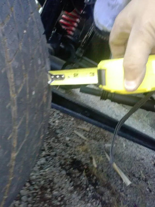

Just like i said lol that picture i had 31s and measuring for 37s so se 3 inches there then three inches straight across from there equals. 6 inches which makes 37
