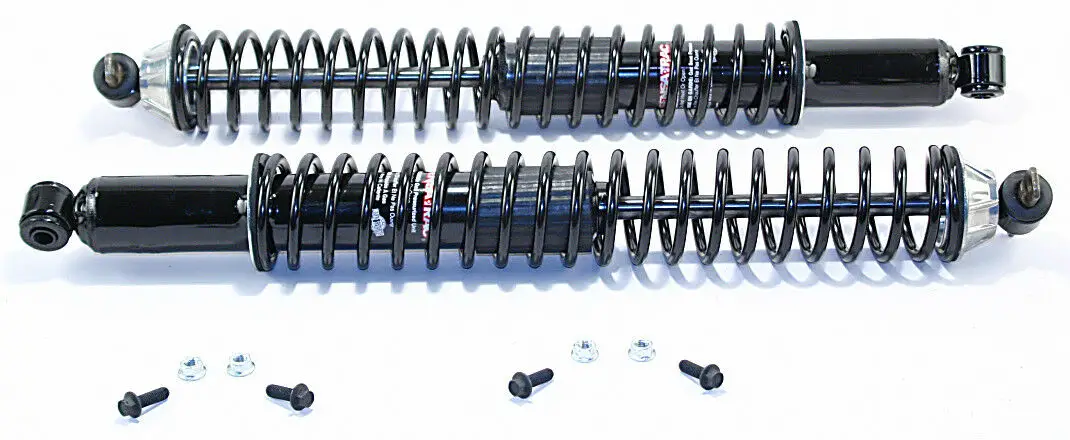

Yeah I would keep them on since they basically leveled you out. AAL isn't hard just takes little time and patience. Just undo the center ubolts then the front spring bolt then the back. Cut off the center bolt with an angle grinder and put the new leaf in and get a new bolt to put in the center. Then just bolt everything back up.
