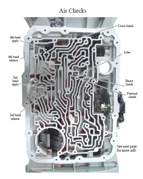

If 4th gear is the one that is giving you trouble and you have a delay into reverse it would indicate a problem with the direct clutch drum, this drum is needed to have 4th, 5th and reverse. Could be a cut sealing ring on the center support or a problem with the seals in the drum itself or a leak in the hydraulic circuit, maybe you forgot to tighten the torx bolt under the valve body that tightens down the center support.
You may be pulling the valve body and air checking the direct clutch drum, this should let you know if the transmission will have to come back out.
Ok, thank you so much for the info, now I have a direction to move in, when I check the forward clutch, should I hear any air leaking out? Or should it engage from the air and not leak? Again, thank you for your time.
Make sure you check the direct clutch, you will hear some air leakage but you should also have a good "thunk" when air is applied. Use the forward and coast clutch air check to get a idea for what it should sound like.

Ok so I air tested the forward and direct drum, they tested good, I heard the thunk and barley any air escaping, i retested the solenoid pack again and it tested fine, I was thinking though, could the pump cause this? I left the old one in from when it got hot,
