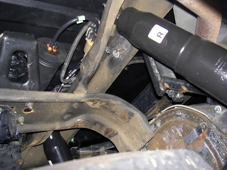

I would try to save the ARC system if it might be intact, most have been removed or ruined by now. The compressor is reliable, but not made to run constantly. The weak links are the shocks that might be fine for 100k miles(is that a weak link), and the air connections. Spray the air connections with soapy water like hunting a tire air leak. They may leak barely, but shouldn't be much. They all have a tiny plastic collar inside which is basically a seal, which are replaceable if you go through sources that sell the air suspension parts(air solenoids, driers, compressor, lines, and o-ring kits).
I installed a 98 ARC system from scratch into my 99 when I reconstructed it, not using the front shocks or lines. I installed a 99-01 ARC module(rear shocks only), and it worked great for 7+ years until the trans went out.
The ARC shocks can still be bought for about $80+ each I think, I paid about $50 each once long ago, and lately I saw them for $80 or so on eBay.
Be sure that the ride height sensor is still there also, and properly attached, lubricated. That has to work right or the pump will run erratically.
