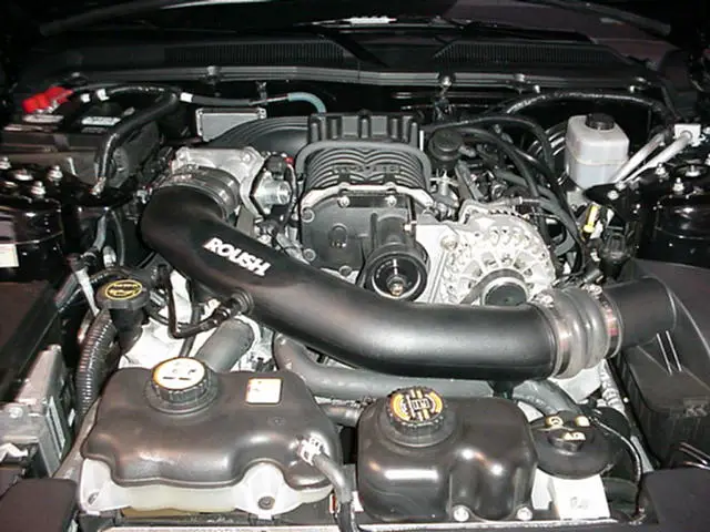

You could also look at building a bad ass 4.6L and stuffing it in there
5.0L = can fit using available parts, retain your AC key to this conversion IMO is using a 5.0L Explorer donor GT-40 engine donor from an Explorer. KNowing your ST is a Gen II ex under the hood and Ford made a 5.0L explorer shows you this is the easiest and cheapest conversion
Looking at like 215 RWHP I believe from the stock 2wd version.
4.6L can fit with more mods to the truck including exhaust, steering, brake master cyl, etc That engine is a HUGE ***** under your hood. This conversion is becoming more and more popular into rangers
5.4L has been done even with the blower, its a good drivetrain from Ford and closest to your goal numbers
