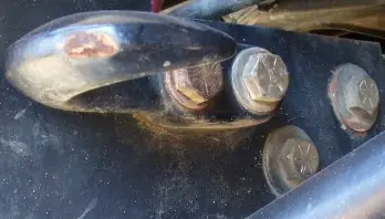

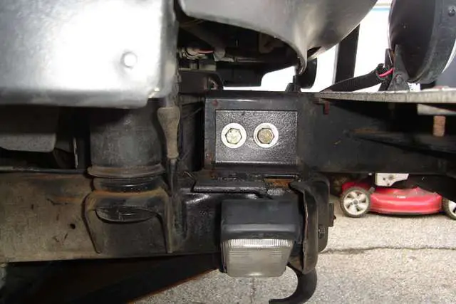

Here are the mounts on my rear bumper:
Mount 1
Mount 2
It is mounted with 8 bolts. Well spaced.

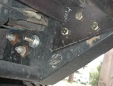

Here is my front 4 bolts very close together:
Front
I think I may drill another hole per side and fix the front. Also to be considered is that the front has a bunch of tubing on it. It is the first thing to hit and it has a considerable amount of leverage on it when I hit something. The rear doesn't take hits like this- no big crowbar exuting a huge amount of leverage on it when I pound on it!
