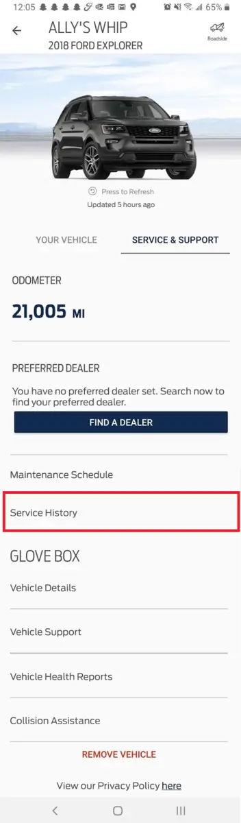

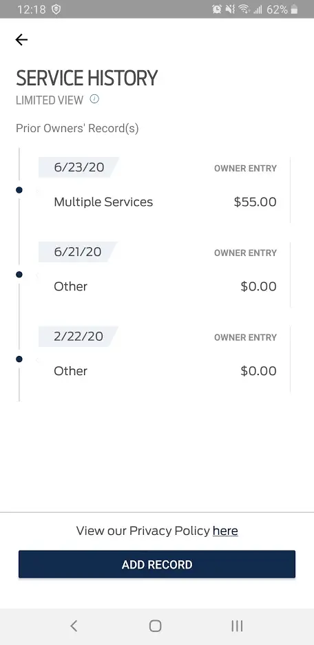

Sorry you had to go through that, I would be a bit upset as well. I was a bit annoyed the service info didn't automatically show up under the Service History section of the FordPass App. Sorry if this is off topic, but does anyone know of a thread that discusses getting the dealer to put that info in following a service? I would love to be able to refer the next owner to the info in the app in favor of a folder full of paperwork. All the services in the photos below were things I added manually following a service:
