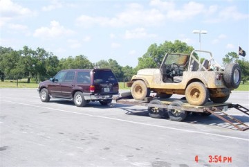

I tow a Jeep on a tandom trailer with my 4.0 SOHC 3.73 rear.
Aldive is that jeep and trailer being towed off the bumper or do you have an optional hitch installed?
From everything I've read (I was looking at a camper at one time) the bumper can't support enough tongue weight for a big trailer with a load.
David

No, it a Class III Hidden Hitch.
