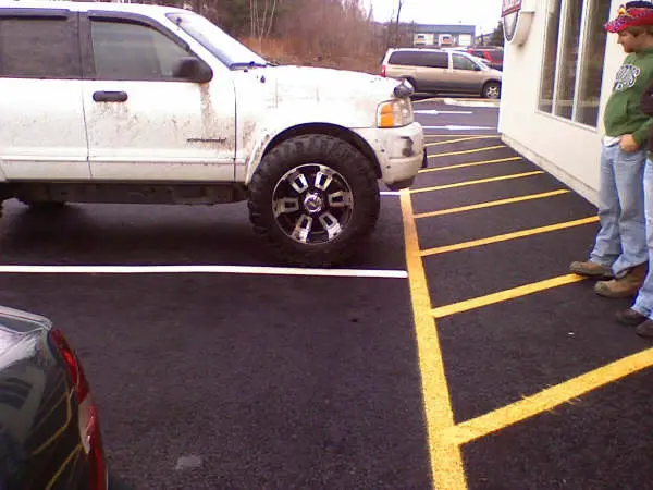

This is a pic of an Irok 36" tire next to my ex.
Ignore the hummer rims, I'd never go that big, I'll stick with my 16's and enjoy the extra rubber.
