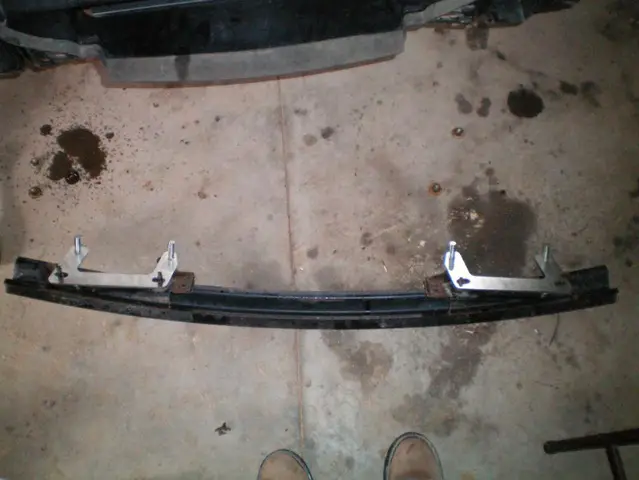

AND did your guys front bumper brackets have two welded in bolts cause mine only has one?
Thanks
Yup, mine did...
I just jacked right in the center on each side, one side at a time.
I used some lumber to get up high enough.
Yeah, I don't see why you couldn't.
