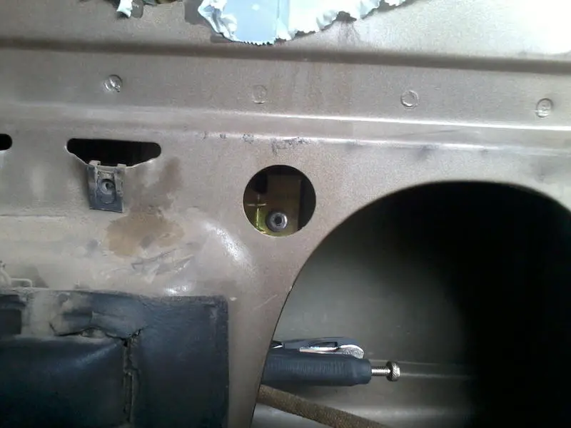

Well maybe I'm just special:scratch: because I'm trying to figure out the mounting point of the new motor.
Another thing, I noticed the junkyard motor had a ground on the individual doors itself, mine does not. (I think it is located in drivers kick panel).
I have tried out the new motor (so far I'm working on drivers rear) and it went up just a little and not down. I'm thinking my switch is shorted out because from the master switch it is the same, I have forgotten to roll the windows up a few times when raining :(.
Any additional advice is greatly appreciated. You all that knock this job out all quick like impress me.... I started on mine at 9 till 2, then again from 630 to 9 till I finally gave up.
..Sorry just saw this last post..:(
..This should help on the location..;)
http://www.explorerforum.com/forums/showpost.php?p=2702653&postcount=36

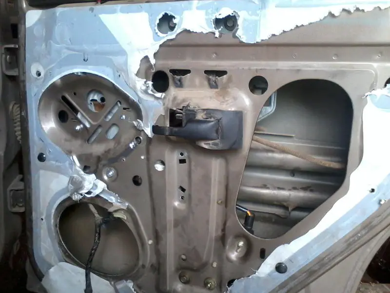

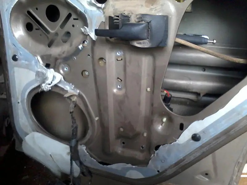

I just got the parts to redo my back passenger door . kbabiac shipped fast & the price is unbeatable at 45.00 I will post some pics when I get around to putting it in . I fish a lot .!!! LOL anyone who has problems needs to do this switch . :D
..Looking forward to your repair and the pictures..:D
got rid of cables

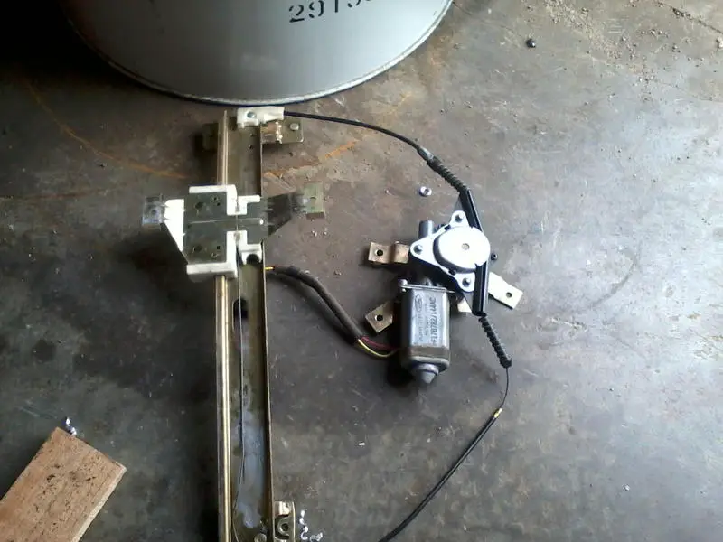

These are the parts I got from kbabiac .

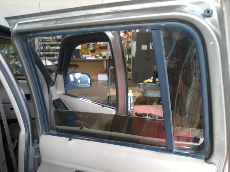

This is a close up of the window rivet & it is knocked out . I used a piece of wood wedged behind the rivet to help in its removal .
This is all the rivets after I knocked the pins out & drilled them . Notice the vise grips I used to hold the window at the right height
This is the bad reg. I am updating .

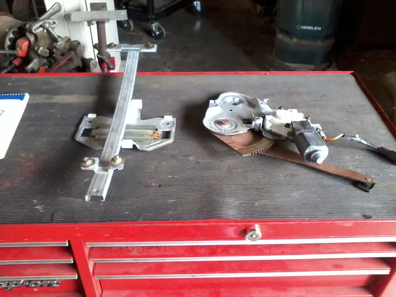

This is the new set up installed
This is the finished product . I am going to recommend that you get the rivet kit from rock auto as one bolt is just nearly impossible to put in . If you look closely at the fifth pic you can see one rivet in it . . I had about 1 1/2 hours in the change over . saved the old motor to replace one of the fronts if it goes bad . It works great & thanks so much to every one involved in this . Happy motoring tbars4 , thanks to you kbabiac & others .
