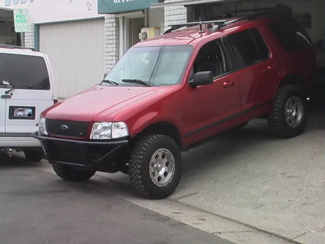

Yes, the lenses are interchangeable, so you can just put on clear, red or amber lenses. Mine will be mounted just under the head lamps... behind the tube.
Very sharp rig! It would be nice to use the stock fog switch doing the fog mod, but you would lose some voltage and brightness. If you power down to the 35 watt and do the fog mod you might not be happy with the results. Trial and error, & personal pref. Up to you.
