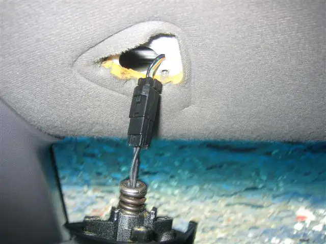

Next, remove the post for the visor on the console side. It just slides out rather easily. Then you can slide out the opposite side.
With a little wiggling the connector will slide out of the hole. I used a small screw driver to compress the clip and pop it apart.

Installing them just takes connecting the plugs, inserting the small visor into each clip. I found putting in the console side easier. Make sure to properly get it seated with the spring clip touching the flat side of the post. Once again, be careful, the posts are weak.
