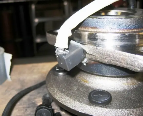

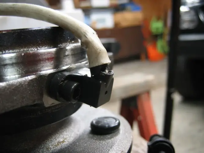

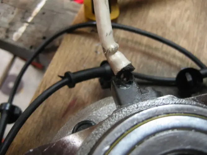

F^#K the part that i ordered came, but its broke.. and of course i didnt figure that out until i had the whole front side apart :rolleyes:
im going to call the company monday i guess.. does anyone think it would have been ok to install it like this?

if that ABS sensor/wire is the only thing broken, you could pull the one off your old hub/bearing assy and install on this one.
otherwise... it would fine, but your ABS light would be on
I would also just swap the sensors. The 4WD ABS sensors don't fail hardly at all, I probably could have four or six spares by now.
would i lose my abs? i thought about swapping them, but i didnt want to take the new one apart, because its glued, and i didnt want to void the warranty on it. also i dont know whats inside there.. is it a bunch of wires, and complicated?
