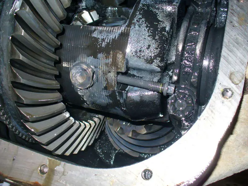

I know this is older but I have the same rear end but my axle shaft broke on the outer end where the lugs are and I can't remove it. The c clip is out and everything but I'm stuck and have no clue what to do. There's not enough axle sticking out to pull it. Any ideas? I'm desperate here I need it fixed by noon tomorrow, any ideas are greatly appreciated. I've tried pushing from inside the diff also.

It is easier than you think.... and you are on the right track.. you have to push it out..
Take the axle out of the other side.. Now take a broom handle and shove it down the axle tube (good side) and push the broken axle out..
~Mark
Edit: You will need to pull the pin too. When you take out the pin retaining bolt I recommend you put in a new one.. They do break if re-used multiple times and are a pain to remove once broken.
I was afraid I was going to have to do that. Which pin are you talking about? Thanks for responding I am pretty frustrated here and can't afford to pay a shop to do it. I'm assuming I will need to replace the other axle shaft seal and bearing as well?

He's talking about the cross-pin.
And you don't have to do the bearing and seal but, since it's already apart, it wouldn't be a bad idea.
Otherwise you'll just have to do it all over again.

I'm trying to drill into the old axle to get a better grip on pulling it out. I removed the c clip, the pin and metal rod, so it should be free. Gonna try this route first and will keep you all posted.
Also, the pin bolt looks brand new so I think I am safe there. I've already maxed out my parts budget. So far I've spent just over $350 on the axle, rotor, gear oil, rtv, and the right tools to do the job. My whole family thinks I can't do it so that's my motivation to do it. Lol
depending on where it actually broke off, you may just be able to nudge it through the housing with your hand/finger/maybe a screwdriver.
of course if it broke off far enough inside, you'll need to find a way to wedge the shaft back in to the bearing, or just pull the seal and bearing.

I GOT IT OUT!!!! Now how do I press the new lugs into the axle?? I have a c clamp but no access to a press or the funds to have it pressed in. Any ideas?
