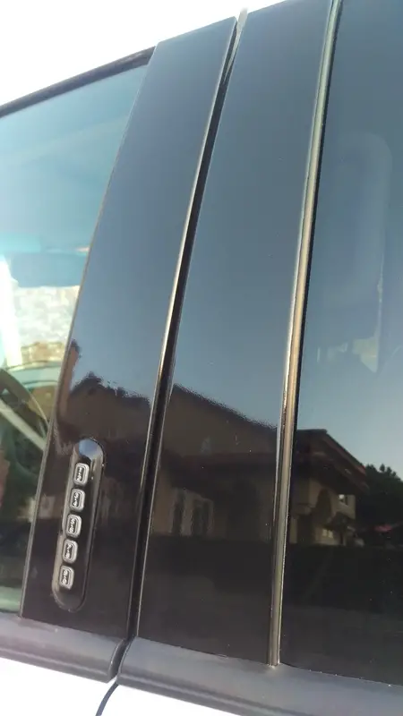

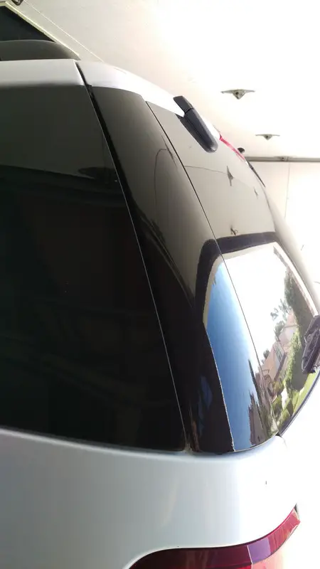

Figured I'd revive this thread after finally deciding to do something about the faded pillars on my Ex. Originally I was going to go the spray paint route but after reading PDX's success with vinyl, I decided go with vinyl for all the plastic trims (much less work than painting). The faded pillars/trims were a real eye sore and now my SUV looks new again.
I had purchased some oracal 751 online and underestimated how much was needed, so I didn't have enough to do the rear pillars. I searched for places that did vinyl wrap on cars in my area and bought a sheet from a highly rated place. His shop used Avery and he explained to me why he liked Avery over other brands and gave me tips on installation. Once I got home and applied the Avery vinyl, I could see why he liked it compared to oracal. It was stretchy and more forgiving if you left an air bubble. The stretchy material is also a bonus for the rear pillars that are curved. The Avery glossy black matched the oracal 751 glossy black pretty similarly, but the OCD part of me wanted everything to be uniform with one brand of vinyl so I took off the oracal I had applied to the other areas and put on the Avery vinyl. Overall, if anyone is looking to restore their faded pillars and trims, I'd suggest vinyl. As PDX mentioned earlier, make sure your surface is smooth prior to applying because any blemishes underneath with show through on the vinyl. I sanded prior and then wiped down with alcohol to get a clean surface. I'll post pics later on with the end product (it's been two weeks with vinyl now).
Do you use heat with either the Oracal or Avery product? Can you be more specific which Avery product you used? Thanks.
The specific Avery product is the Supreme Wrapping. It's made specifically for cars. He cut me a pretty large sheet for $40, so I have leftover if needed. I didn't have to use heat to apply. Just made sure the surface was clean (I used a wax/grease remover) and laid the vinyl on. You do have the option of using a heat gun or blow dryer if needed though. I forgot how high of a temp the wrap can withstand (he told me but I forgot). The flexibility of the wrap made it easier to apply on the pillar where I have the keyless entry numberpad. I just laid the wrap directly over the pad and then cut the opening with a box cutter.
