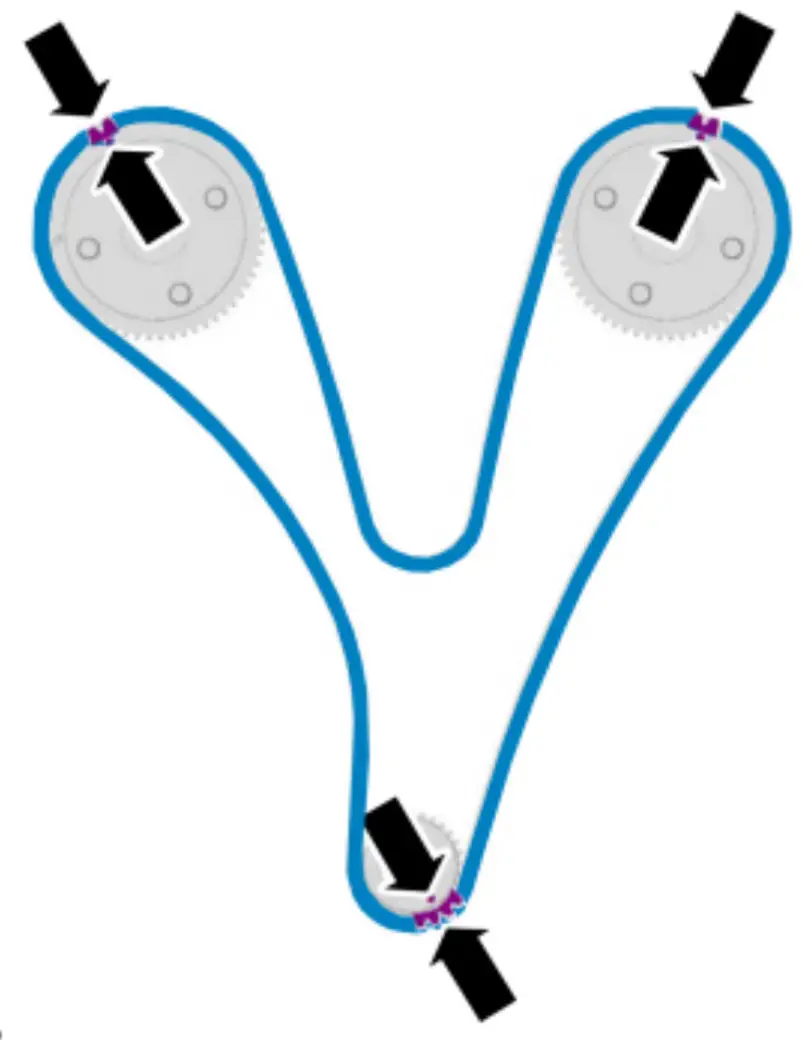

Did you remove the small VCT chains, or just the long main one? Align the colored links with the timing marks
just the main one, the other ones i did not touch them
Thanks for the diagram, it give me a big idea, my other questions are:
Both in clockwise order?

How did you move them when you were changing the water pump? With the spark plugs removed, the engine will turn more easily (no compression). Do everything like before: set the crankshaft at #1 TDC, then install the cam holding tools. Then remove the chain. But instead of pulling the WP, just put the chain back on correctly. You could use the VCT bolts to turn the cams, but it would be better to use the gear teeth (a prybar or big channellocks). Triple-check the timing chain & marks before releasing the tensioner and gluing the timing cover back on.

Now that you know to look for the colored links in the timing chain, you can put it back on right. If your chain doesn't have colored links, buy a new Ford chain that does.
