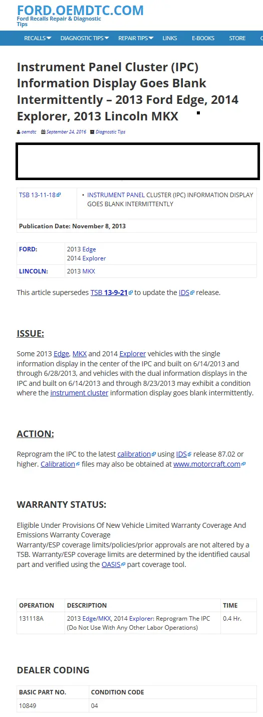

TSB:
Ok. Spoke too soon. Both sides this time went out and came back later in the day. Is the PCM updates ALSO reprogramming the IPC or are they separate. When I went to the dealer I explicitly paid for and asked for ALL software "bumper to bumper" to be updated and was told that it was all updated through the main computer.

I would guess that they are separate since I don't see a connection between the Powertrain Control Module and the Instrument Panel Control Module.

I had the same problem on my 2013 XLT. It was a bad LCD screen. I sent it out for repair to this place instrumentclusterstore.com. They charged me $150, quick turnaround. The challenge is removing the instrument panel. It would be better to ask a body shop to help you remove the plastic trim that surrounds the panel. Once that part is out the way you will see 4 screws (7 mm hex). Just remove the screws and disconnect the harness in the back and you can ship the panel to the repair shop.
