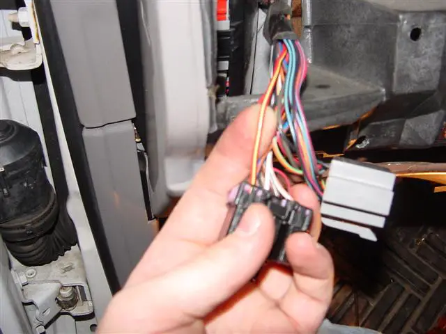

If you remove the fuse panel on the drivers side of the dash, I believe 3 screws and it will pull out some, you'll have access to the headlight knob. If you tap into the Red/Yellow wire you'll be golden. This is the kick on for the headlights. It is also the one used for the autolamps if you have/use them. I don't think you need to remove the entire dash panel to access this group of wires.
Could I have that going to the red wire from the lights? Or do I need to wire up a different power source with a relay?
If you were just using LEDs, you could use any signal wire. I don't know how much power the cathodes require, so I can't say if you need a relay or not. Its probably best to use one however.

I ran some red l.e.d. bars that have 9 l.e.d's on it on both sides under the dash. It doesnt hinder my vision. You cant really see it when your looking at the road. And i ran it to the 4 wheel drive switch that really isnt there. My car is only 2wd but the switch along with the wires are on there. I knew the switches on the bezel light up when you turn the parking brakes on so thats why i did it. There is a red wire thats positive on the clip and then black thats the ground. The clip is above the cigarette lighter on the driver side of bezel.
