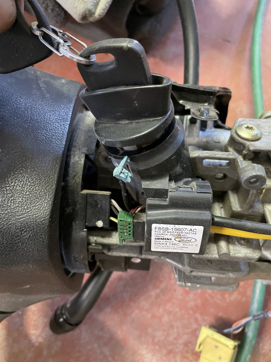

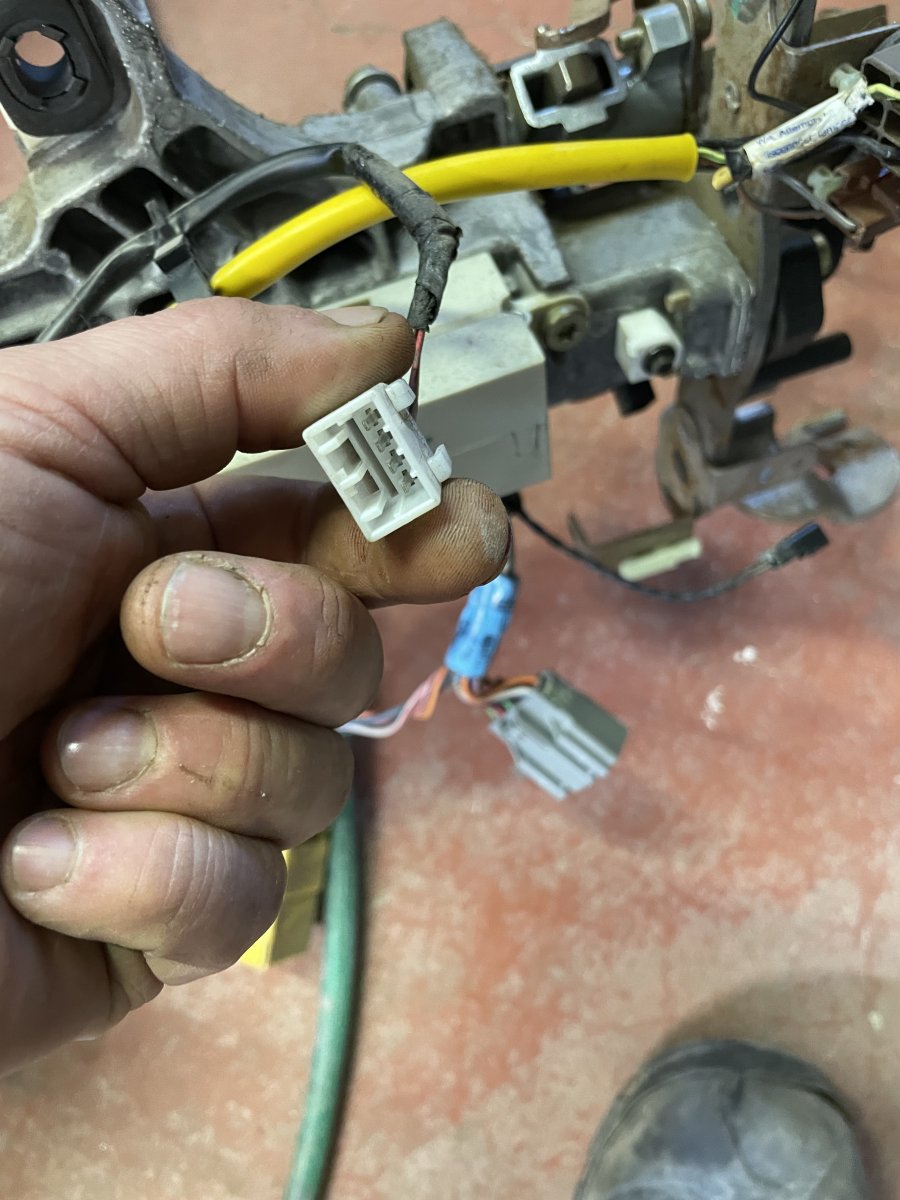

Here is an example of a pats transceiver or “halo” as we explorer dudes call them
Match up your wiring connector w the new one if you purchase
Access is through the knee guard on drivers side under steering column several 7mm and 8mm screws . Also 3ea Phillips screws for column shrouds halves and a pair of plyers to loosen the tilt wheel lever.

I’m right next to a 2000 ranger steering column right now so I snagged some pics

I do not know if this happens to older expys but I had a same era Taurus that did this and it was the PATS wire on the steering column. I used the tilt wheel every time I got in and out of the car and it eventually broke the wires in the yellow sleeve that go to the PATS induction coil. Something to check. I fixed it with a few bits of wire and solder extending the harness.
Fixed this recently on my 01’ Explorer Sport. It’s as simple as taking the drivers side kick panel off, the clamshell around the steering column and then replacing the PATS transceiver. Had this issue for a while where sometimes it would work and sometimes it wouldn’t. I got my replacement for like $30 on Amazon. Easy replacement and it fixed it right up for me.
Yeah I’ve found this is the main cause of the transceiver going bad. The steering wheel tilt just ends up pinching the wires over time and severing them. It’s why in other threads you’ll see people fixed this issue by just hitting their steering wheel or tilting their steering wheel up and down to reseat the connection.
