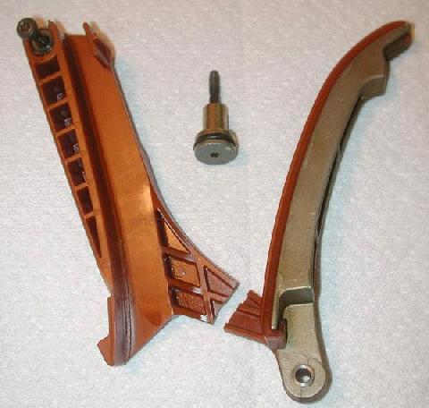

Man this is a tough call. I think I would try to get a junk yard one and go that route. That is a pretty high mileage vehicle to drop 2 grand on.....but that being said the 4.0 is pretty good engine for sure. The whole tensioner issue is there, but there are a lot of explorers that never have that problem. It is not a really pervasive problem from what I have been told and experienced.
updated tensioners & cassette guides
Your 2003 has the significantly improved tensioners and cassette guides but the rear cassette guide is still not reinforced with metal on the traction side and could possibly break at any time.
Replacing the rear cassette requires either removing the engine (preferred) or the transmission and could easily cost $2,000 or more when performed by a dealer. If your vehicle is in good physical condition, you plan to keep it, and you don't work on engines or transmissions then a rebuilt transmission (or rebuilding your failed one) with an extended warranty is probably your best option.
