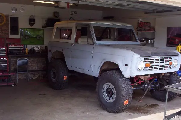

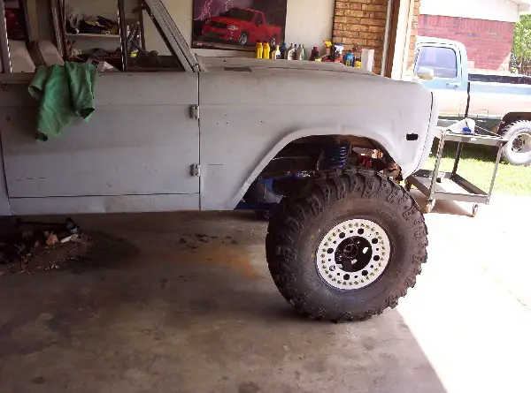

I got the frontend on the ground Friday. Everything is tacked into place and lined up, so as soon as i can figure out a tracbar mount it will come back out and get final welding. The tracbar hits the crossmember just sitting at static ride height so the frame mount will need to be right under the steering box. So, im leaving it alone for a while and working on the rear... as i get the rear done ill figure out a tracbar mount.
The leading edge of the tires are even with the front edge of the headlights. I think i might need to trim the fenders some. :D

holy approach angle! nice work
Whats the final wheelbase?
Oh fantastic :D
cool stuff. looks good - I like the IROKS! Keep up the good work and I'm excited to see a final
