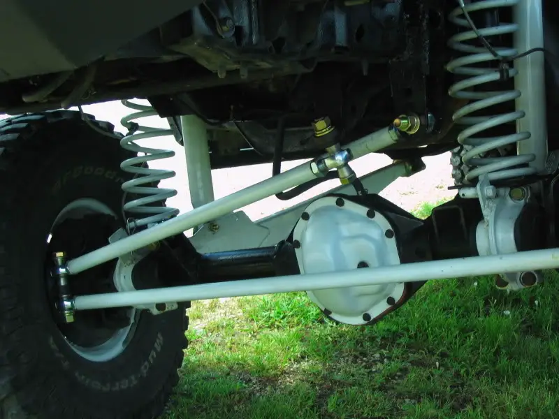

That's a lot of torque on that 1 little bolt. The heim is adding quite a lever.
It's really starting to bother me. Is there something you can do to strengthen that connection??
I can just see you bounce over a rock and squarely into the next and snapping that sucker or worse, twisting the pitman arm (or even worse yet, snapping the sector shaft (ask Diff Whack Daddy))
I don't like it much either, but that is the only mis bushing the company says will work correctly with that joint. Changing all that would also move the angle higher. I'm telling you guys I don;t have much more in me, so, as far as the front end goes I really need it to be finished. Not feeling luv today at all, and my spine has been telling me lately to get another hobby. Right now it is all I can do to control my fingers typing. I can;t lay down for any lomger than I can remain passed out from fatigue. This is getting nuts.
The bolt is 3/4"
The only time that bolt would shear off would be on a severe trail impact. Maybe I should install a grade 5 bolt there for trail use, and consider it a "fuseable link" to protect the other components?
I truly intend this to be a trail use "Rig" . I would like to be able to get in to see other's tackle obstacles but will drive around most of them myself. Just a normal colorado back road is enough to tear me up, I don;t need to be falling off drop offs and climbing over boulders I cannot roll out of my way.
Definately carry a couple spare bolts and associated tools to remove a damaged one.
