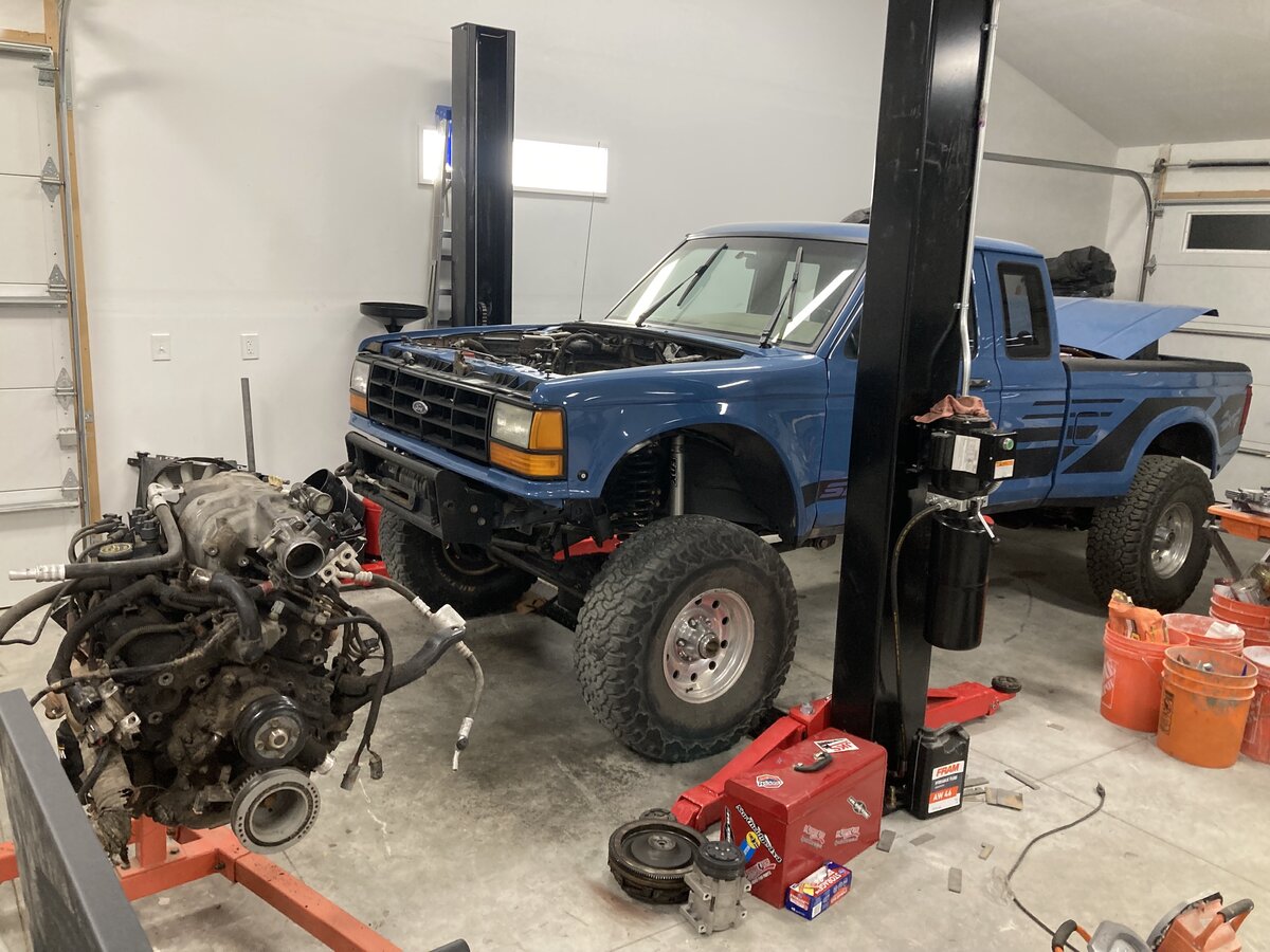

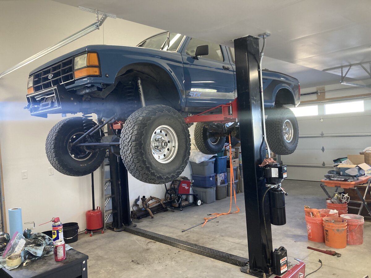

Well, it has begun. I ordered a ton of parts. Like a ton. IDK if I said yet, but the block is a 98-2000 remanufactured motorcraft short block. I got some new old stock 95TM heads off eBay. New melling rockers and lifters. New for pushrods. New seals and gaskets. New water pump. New everything I could think of.
I have a crazy summer planned- but my little girl is going to be 16 in a week and I need to let her drive her bronco- so I started yanking the engine.

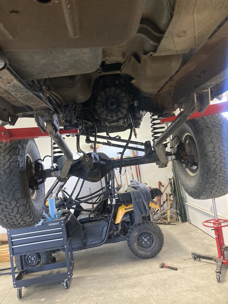

I started with the tranny. I am going to have it rebuilt using a 4 cylinder 1st, 2nd, and 3rd gear set. I need to grab a 4 cylinder tranny from a junk yard.

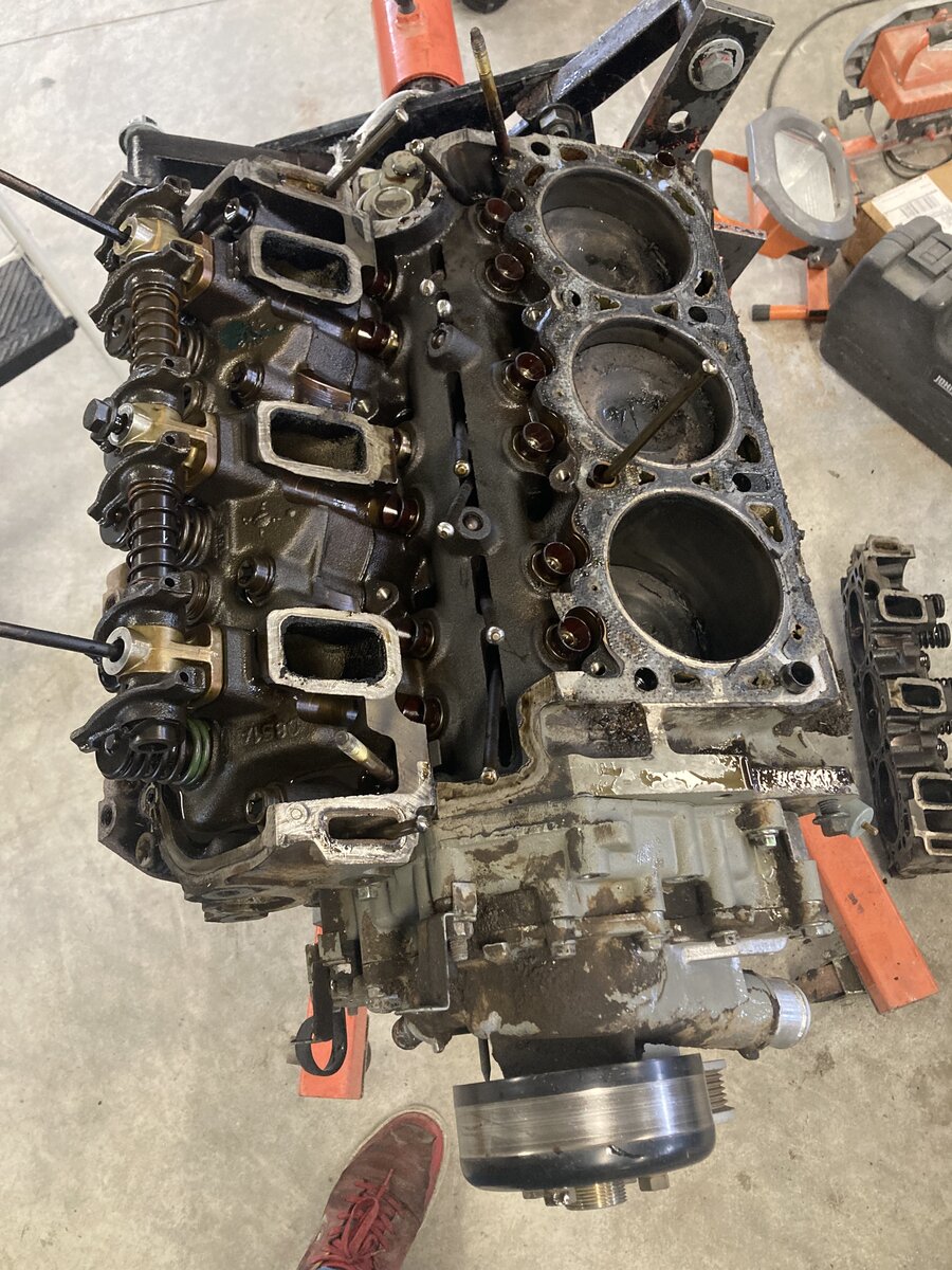

Started taking apart the old engine. Not stoked to get it all cleaned up. There is a lot to do. It was leaking like a gunshot wound for years.
Pretty good internal shape. Pushrods are definitely worn. My kid thought she was funny with the pushrods. There was a ton of oil in the intake and exhaust. Like a ton. lol.

Your drivers radius arm is missing a bolt lol lol lol really nice setup you have there!! Lifts are so handy
