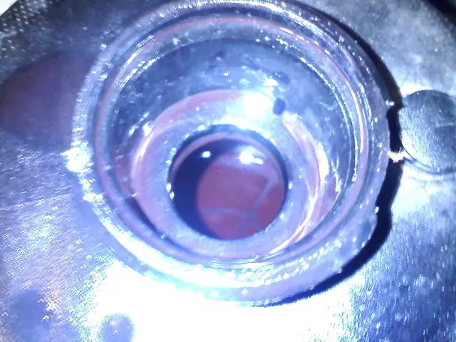

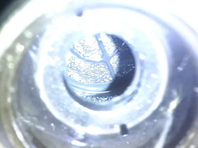

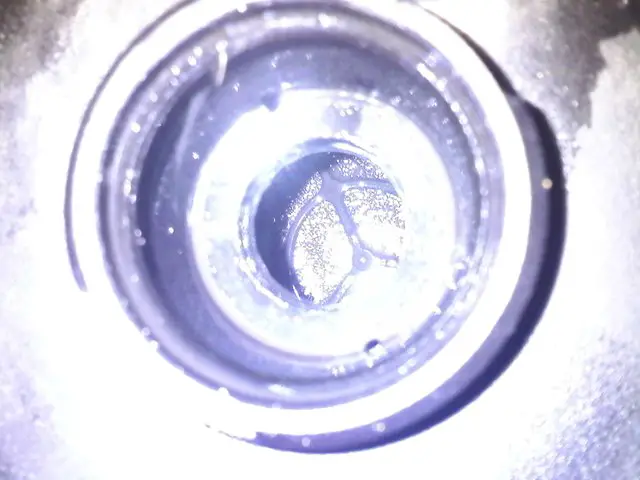

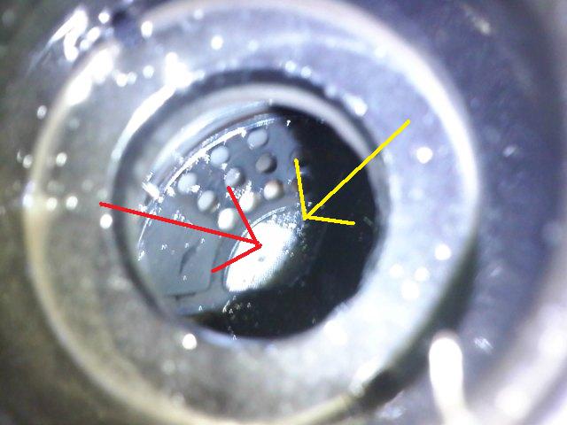

So the power steering shutter that I was having. Was dirty fluid and a clogged screen in the reservoir. I pulled the fluid out and noticed that the screen that is in the reservoir was plugged with just crap from bad fluid and things. So Pulled the reservoir off the truck and cleaned it really well then put it back on the truck.
Here are some pics if the screen and the crap plugging it.
The red arrow is where the screen is clean from where my sucker gun sucked and the yellow arrow is all the dirty crap you can see how much crap was in there. I think what was happening is when the pump would demand fluid when it was asked to work the dirty screen wouldn't allow the fluid to come through and feed the pump so it would let air in and thats where I was getting my shutter from.
So back on the truck and put new fluid in and worked the air out of the system and then sucked it back out new fluid in then work in, on and on until I had gone through a quart of new fluid. Now the fluid at least looks red again. I will drive it for a day then pull it out and run some more new in and do that for a few days until I get this other quart gone through. Then the system should be good to go. The truck turns better than I EVER remember it is SO smooth and can't fell the big tires when turning when stopped and things its great!!!! So nice, o the things that age and miles do to our trucks. See how clean the screen is and the fluid is the right color !! :)

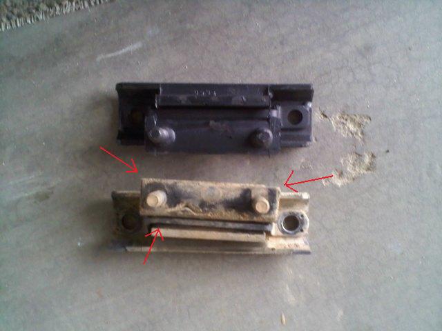

Did a new trans mount today, the old one was defiantly shot. You can wiggle the mount in your hands. And it was bent! I think that this came or would have to have come when the front drive shaft insinigrated at 75 mph. The CV locked up and so would wobble so it was shifting the engine and trans back and forth that is why the mount is bent I think. Anyways new one is in and looks great :) it did help and holds the T-Case off that tank bracket :) You can see where that little bar that goes across it is bent when it should be straight like you see on the new mount. You can see the difference between the top two red arrows.
Good find, that $22 part isn't as strong as a urethane mount, but much better than the old stuff.
I know wish that I could find a urethane one for the truck. Would be nice to have but for $17 it was good to change :) When that shaft locked up it screwed a bunch of things up.
Yes, I looked also but between that and Jamie not having found something, this works I guess.
