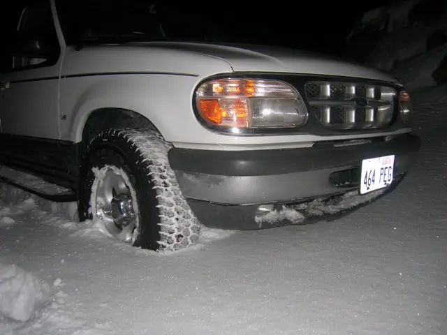

More deep snow tonight!! This time from it snowing more it was very deep. 4 Low came in handy a few times was great!!!!!!
Pics of my fun. And my roommates jeep with us to, pulled him out had that thing buried :)
