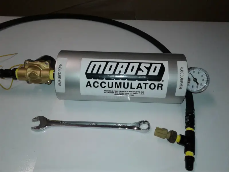

I have put brand new tensioners into this Ranger engine and we did spin it up to check them, all is good. I did not like the $200 price tag on the solenoid from Moroso so got a high class made in China version for about $25, plus a timer circuit (adjustable) to only keep the solenoid open for a limited time, we'll see how it works out, I may be whining again in a few weeks and shelling out the $200...

Adding the Moroso picture from today's playing...

It takes all of 3 seconds to fill my timer is set to 30 seconds

Thanks Don, I'll use that as my initial setting, I'm using the 1 1/2 quart Moroso initially set to about 7 PSI, 4 feet of AN6 hose, and 1/4" ID fittings, the solenoid and Moroso are 1/2" fittings so I guess it empties and fills a lot faster than initially thought, have never used one before. Heading out to the shop with anti-seize for the exhaust manifolds... Eric...

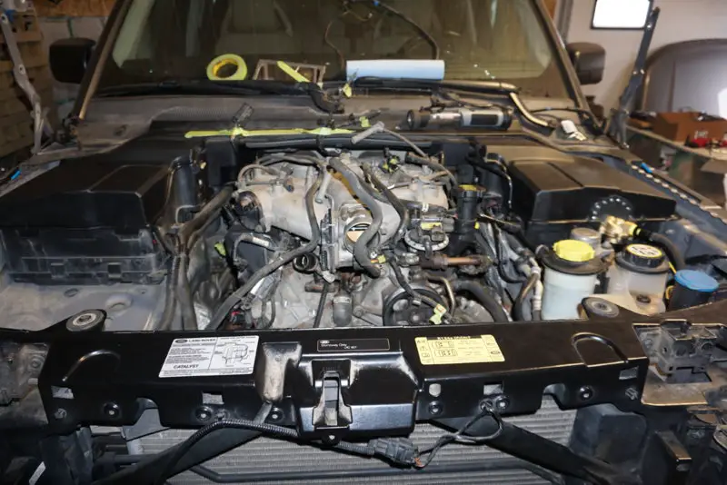

New iridium spark plugs, remove power steering pump and A/C to change out location of wiring harness plus add steering connector bolt (OOOps!). Here's a look at the engine with the Land Rover intake manifold, a huge difference from the Ranger...

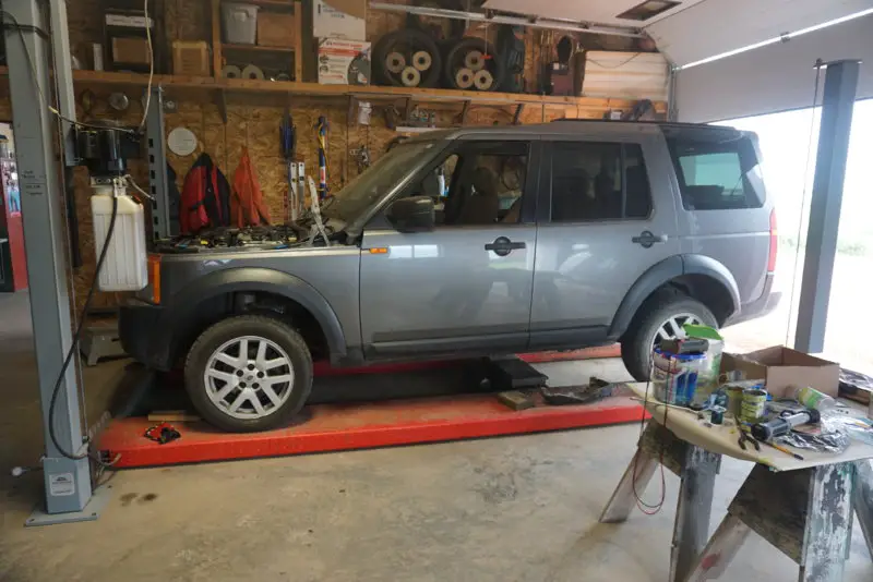

Well the radiator was fixed via an aluminum (or aluminium) welding process, pressure tested and some fins straightened, then installed and filled. At about 1720 MDT today we fired it up, started first crack, idled up to 1200 rpm and after about 2 minutes dropped to 800, we ran it till the thermostat opened, then shut if off and let it cool so we could add some more antifreeze. More reporting tomorrow, we still have to put the hood back on and road test, then insurance and plates (or is it the other way around?). Attached shows how high the air suspension took it up, I have to read about how to use it, obviously I don't have a clue... Thanks all for your ongoing help and suggestions...
