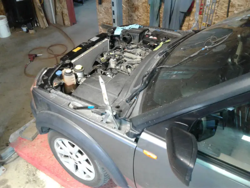

Wednesday July 03
Hood is off (thank goodness it is aluminum), engine fan clutch is right hand thread (lefty loosely), and there is no drain valve for engine coolant, just pull off the hoses. More next week (with photos)...

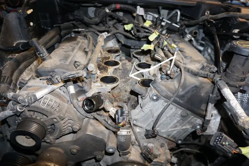

Attached is after we got the custom aluminum intake manifold off and discovered the remnants of a large mouse nest, no mice though. Looks like Land Rover designed this for the body to be taken off the frame to perform mechanical work, took all day to get this manifold off...

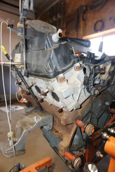

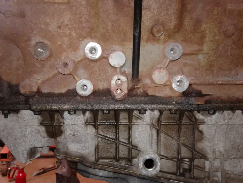

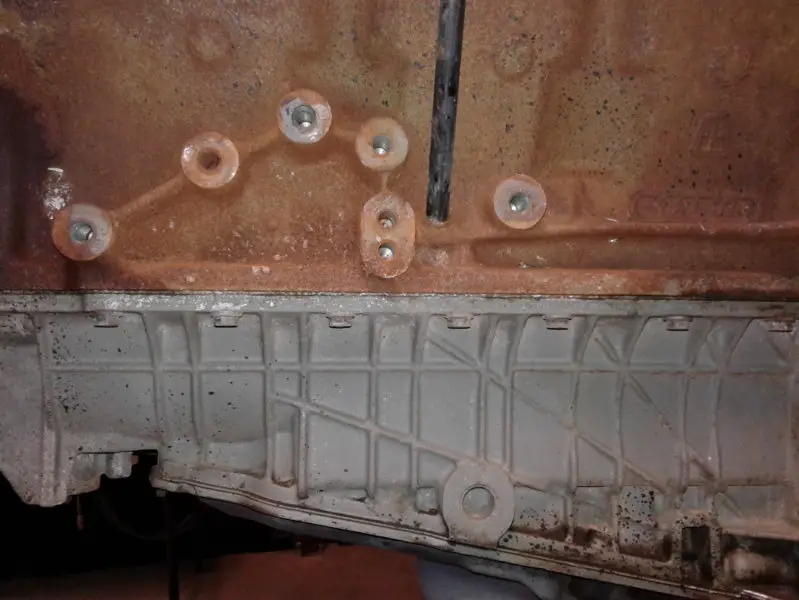

July 16 and engine is out, unfortunately the block on the Land Rover Cologne has different mounting holes in the casting for the engine mount brackets so we have to fabricate the driver's side and perhaps can get away with "adjusting" the passenger side, plus the engine driver's side knock sensor is going to have to be examined as there is no engine side knock sensor on the Ranger. Photos attached
This is the Ranger driver side engine block/oil pan
Land Rover driver side engine block/oil pan

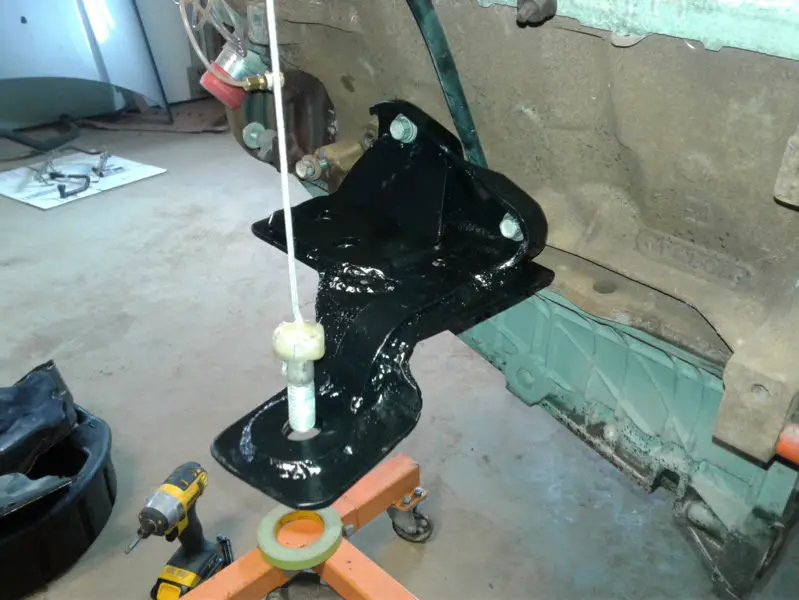

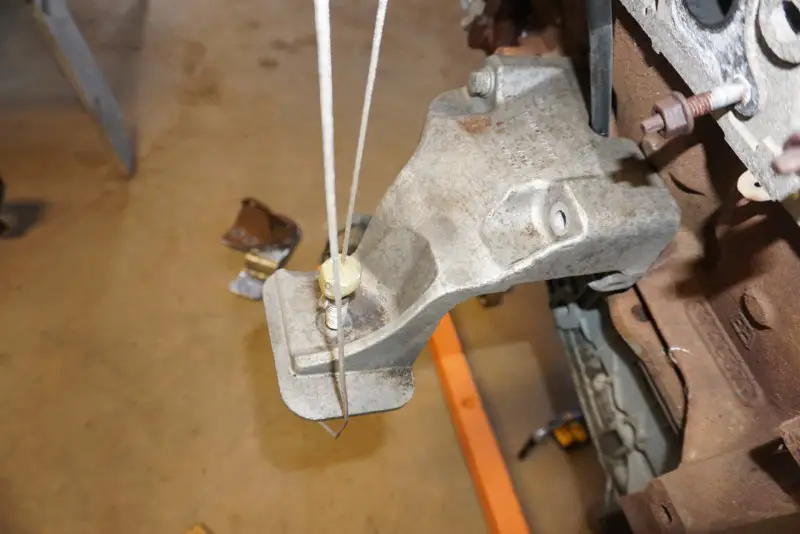

Well my friend is fabricating an engine mount for the driver's side, and attached is a picture of our homemade plumb bob and engine mount measuring device. I wanted to use lasers but string was easier and likely better... First picture is of Rube Goldberg type measuring arrangement, second is of the accuracy using the Land Rover driver's side "aluminium" mounting bracket and our positioning device to accurately locate the frame rubber mounted center bolt. More to come...

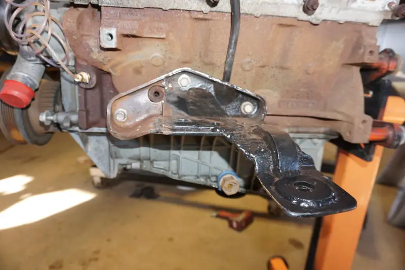

July 18
Attached photos of new and somewhat improved engine mount plus engine oil temperature sensor installation into Ranger oil pan (blue stuff is Permatex silicone)... Edited to add silicone

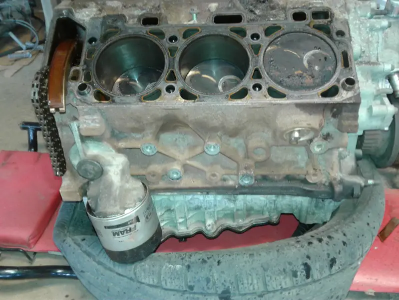

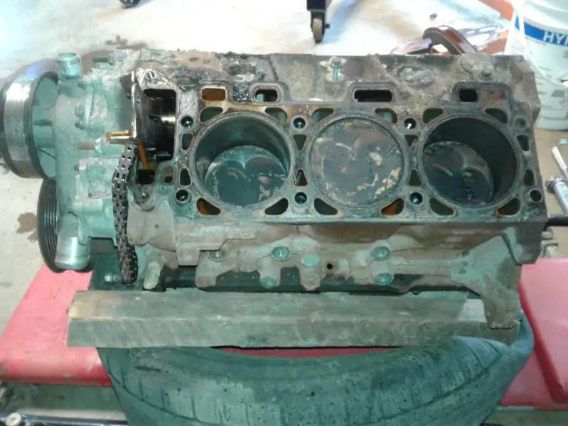

Lots of stuff done today, pigtail for oil temp sensor soldered in and protected with plastic sleeve, flex plate positioned correctly for CKP sensor and torqued, discovered that LR3 engine had all passenger side exhaust valves bent and that is where the chain slipped/failed. Very happy now that we decided to pull and replace the engine rather than replace the front timing chain, that would have been a huge mistake! Likely placing engine into the LR3 tomorrow and hopefully only minimal problems...
Drivers side (Front Chain)
Passenger side (Rear Chain)
Excuse the old tire, we'll surely recycle it!

BTW, do you have any extra room below the oil filter, for a longer filter? If you do in that truck, you could swap the block oil filter adapter, for an older model, and those take the FL1A(quart size) filter. I don't think there are any bigger alternatives for the FL820S, which I have on three of my Fords. The older 4.0's and the first models of the SOHC used the FL1A, only the adapter is different.

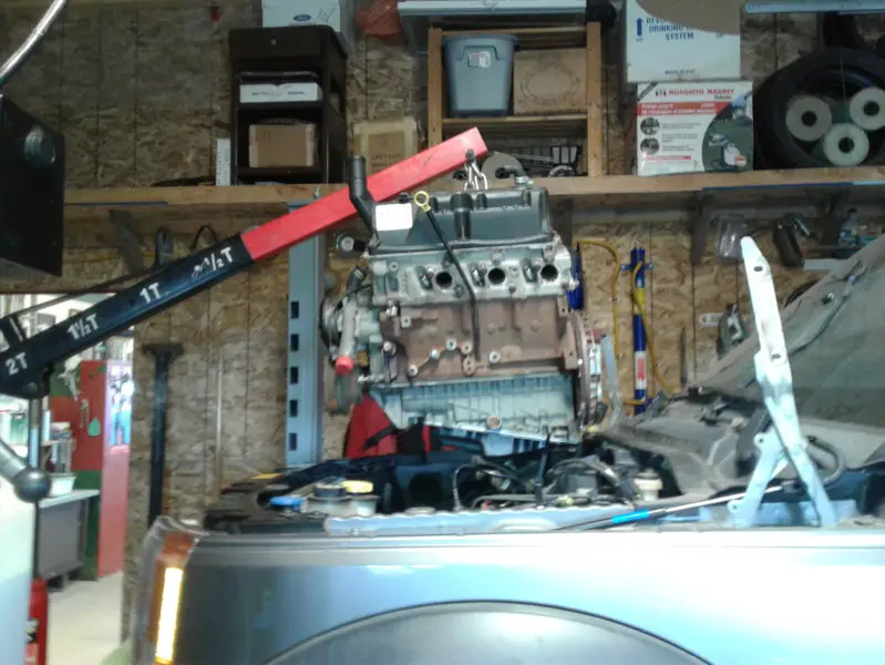

Not sure about how much room there is, the previous photo shows the Ranger oil filter fitting on the LR3 engine, there is a tab on the upper right corner that stops it from being used on the LR3 (we could have ground it off), but I'll check out a larger filter, we just found out that the Moroso pre oiler fittings I got are too large (1/4 NPT to 1/2 NPT I think) and we'll have to custom fit my solenoid to the accumulator, blah, blah, blah. Also the engine transmission to rear of engine bolts were all good until we tried the one where the alignment pin on the drivers side goes in, and we had to saw off 1/8" on the bolt because the tapped casting on the corner is about 3/16" less thick and the longer bolt was having a problem. But hey!, Don't bigger impact tools solve those problems? Attached photo shows Mr. Ranger meeting Mr. LR3 for the first time... It is a bit out of focus, used my phone instead of my camera (forgot it at home)

The oil filter points straight down, so a longer filter can work if the original filter had more clearance below it in stock form.
