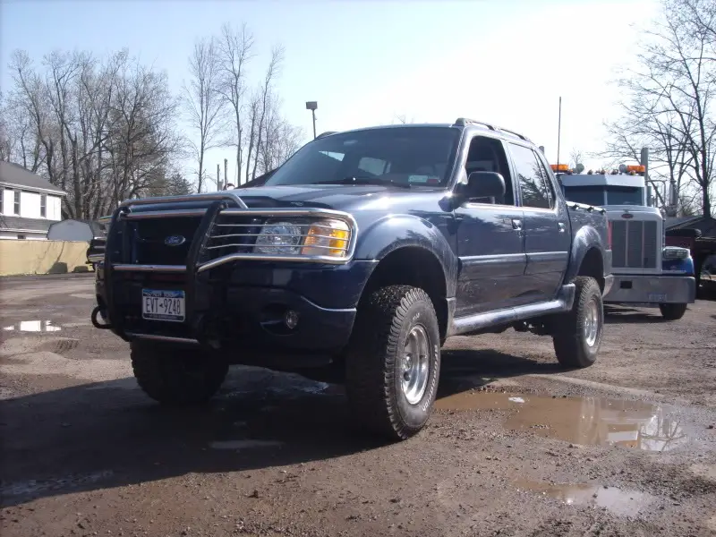

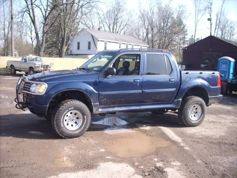

Update!!!! Brush guard back on. Also some more pics for you guys!

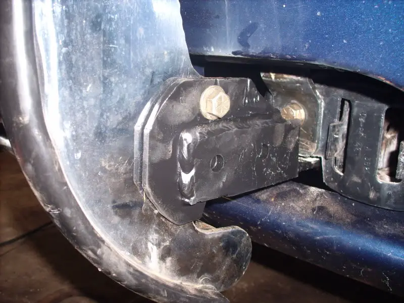

The magic you can do with a plasma cutter and a decent mig welder.
It will work for now. May plan on beefing the bracket up soon!
For those wondering how I mounted my tow hooks afterwards.
Running boards off for now untill I go wheeling next sunday. was going to go today but found out when installing a locker into my buddies chevy that he had two busted leafs. So now I have to wait for him. Damn Chevys.
