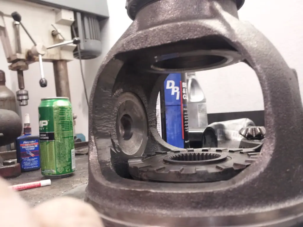

i didnt think to get a picture of the bare carrier but here is the factory side i didnt have to mod...Notice the nice rounded edges of the inside of the case and the amount of meat around it

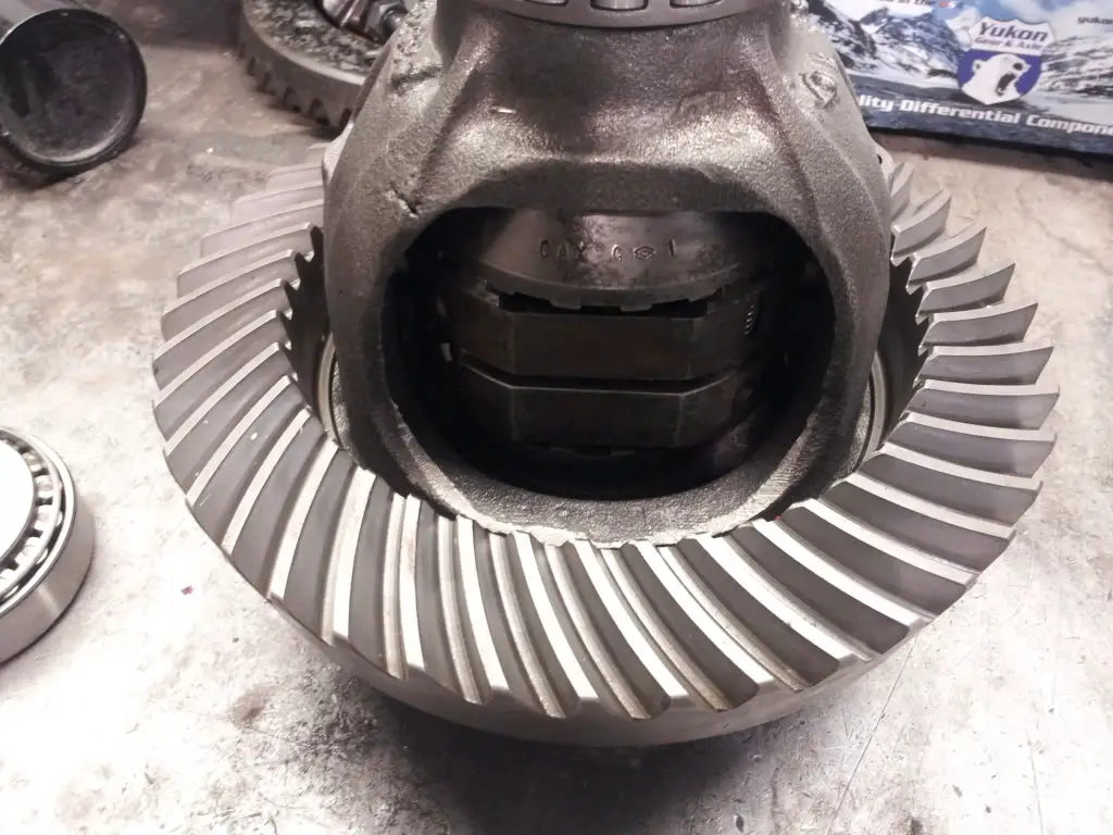

So i started Grinding... this much and still a no-go
now in this last picture where i actually ground enough off for the locker to just slide in.. notice all the curve and meat from the first pic is gone on the opposite side that i had to mod.. one side is now just a square hole...
all in all. i kept all the grounds and weighed them out to just under 8ounces of material removed for the "slight" modification of the carrier... i dont mind though... its a 1-ton
