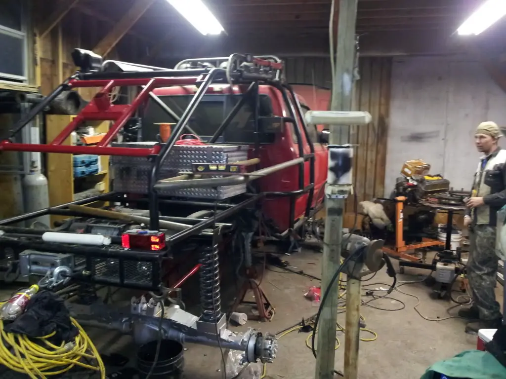

Recently, i heard a new song on the radio by Lee Brice called "i drive your truck", something kicked on when i heard it and for the last 2.5 weeks, me and 2 good friends have been in the shop everyday.. This PIG is getting streetable by the end of the month!!!
Here Goes!!!

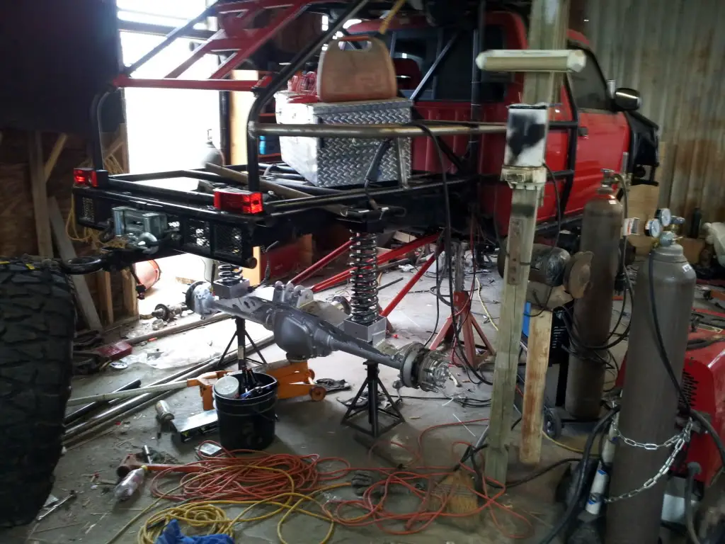

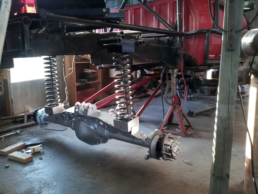

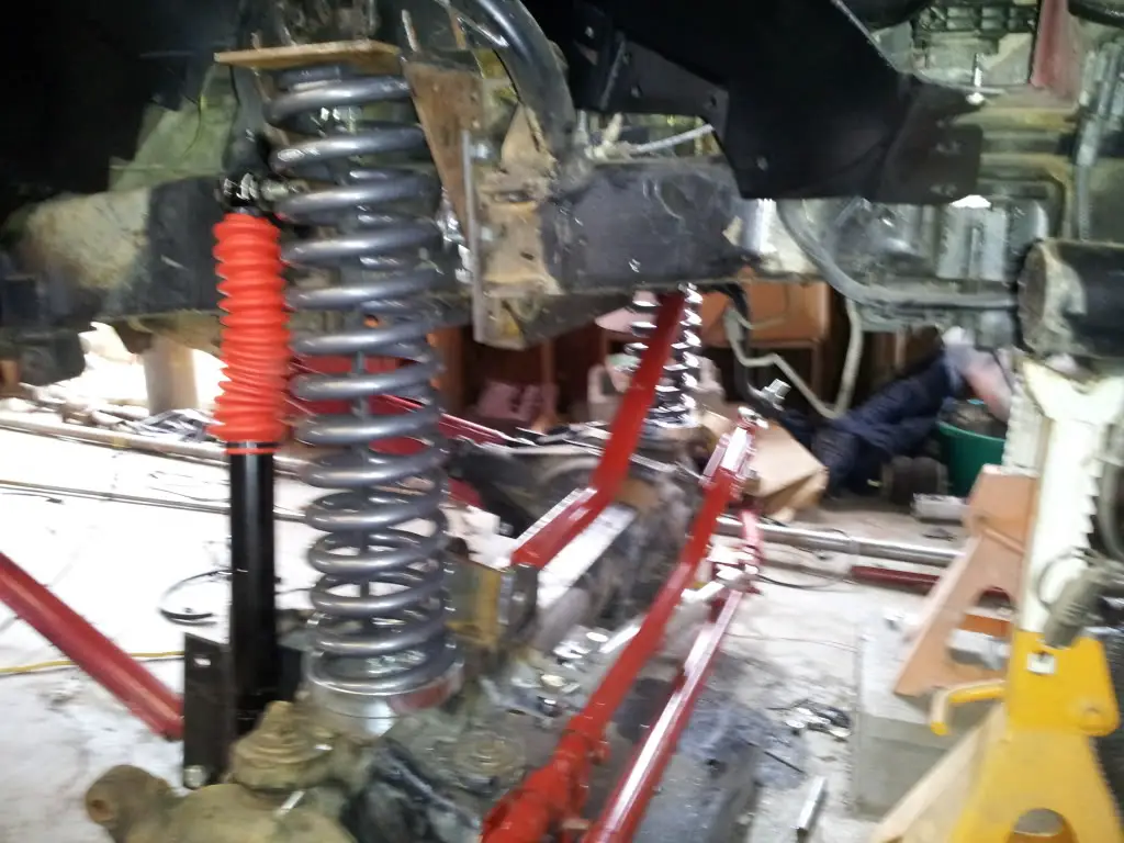

Rear= done except shocks, stuffed with Detroit full-locker, 5:38 gears, grade 43 1/4" chain limit straps shrunk with heat shrink to prevent rattling..

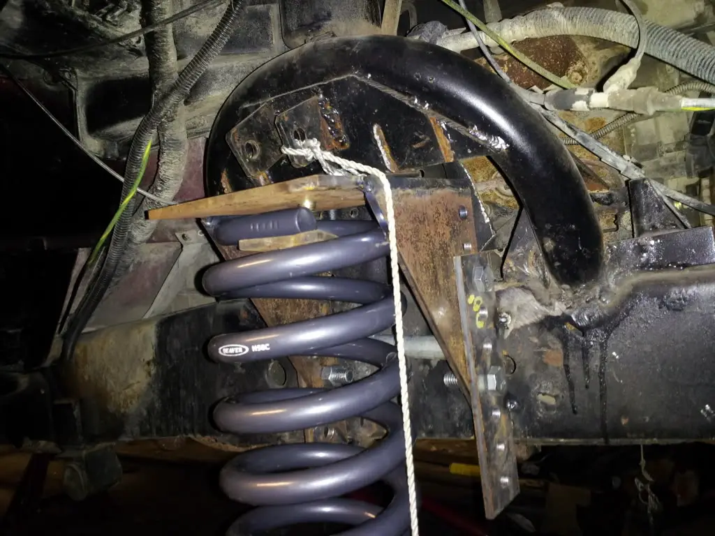

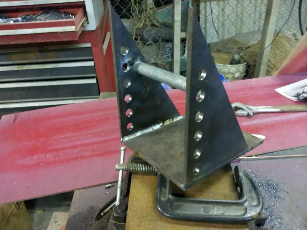

Custom maid me some "ballistic" style adjustable coil buckets for the front
Got the 2-link done(decided against 4-link because i dont want full hydro steering)
I kept burning my toes with slag going through my shoes...FIXED IT!!

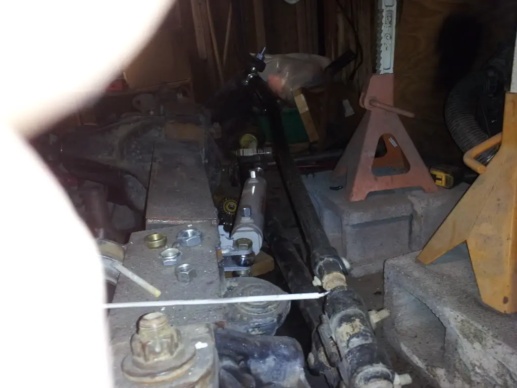

Steering= Factory ford superduty 1 ton tie-rod, factory drag link with a slight mod.. pcs Hydro-assist pump and tapped superduty 1-ton steering gear.

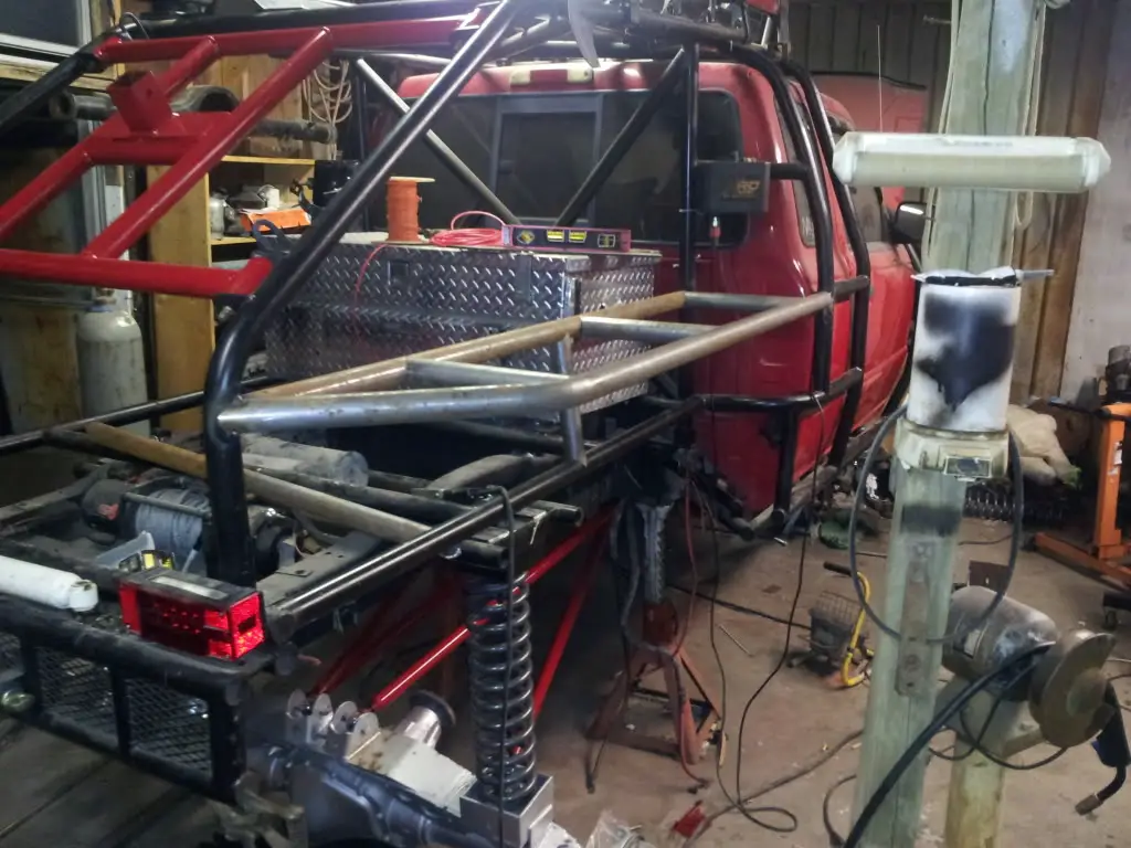

Had to re-design a spare tire carrier that was stout enough to hold my "massive meat":eek:
started working on the flatbed fenders...
other than that, what you cant see.. i got all the electrical wired up, my e-fan wired and switched to the aftermarket water temp gauge.. and various other odds and ends that are being done while waiting on welds to cool off and paint to dry..

So you're using a SD p/s pump?
right now im running the ranger p/s pump with the SD steering gear box, i did that on the first SAS and its been working awsome.. ive been doing some math though and i dont think the factory ranger pump resevoir will hold enough fluid for the PCS hydro-assist.. if that becomes an issue, i will put the superduty p/s pump on the truck with an external resevoir.

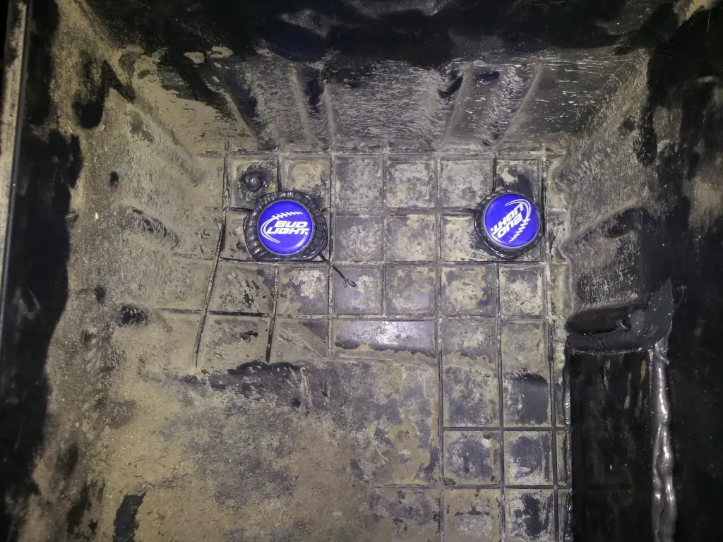

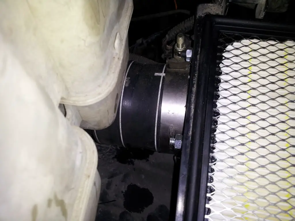

Stock Airbox, started by completely sealing it.. BTW!! little bit of redneck ingenuity... Best Air Box water-proofing EVER!!!
Trust me, thats not the worst of it...:D I broke a large piece out of the vacuum canister along time ago removing it.. Thats bad boy has been running for about 4 years now with a Grizzly can patch! Theres a little bit of me in my truck!
What year range is the box put of do you know?
the one i am running is out of a 2003 F350. i built a truck a long time ago for a guy while i was working at ford.. when i swapped out the 49" iroks for some 62" tractors tires he went to full hydraulic steering and i kept his old box that was factory, and it was already tapped for hydro-assist!
with all that crap said... the year box equivelant to mine will be a 99-2003.
2004-current are identical except that the output shaft for the pitman arm is way more beefy and much larger diameter. And the Pressure and return sides are diffrent sizes.. i fabbed up a cheap return line but my pressure line off the Ranger p/s pump bolted right up to the 03' box.

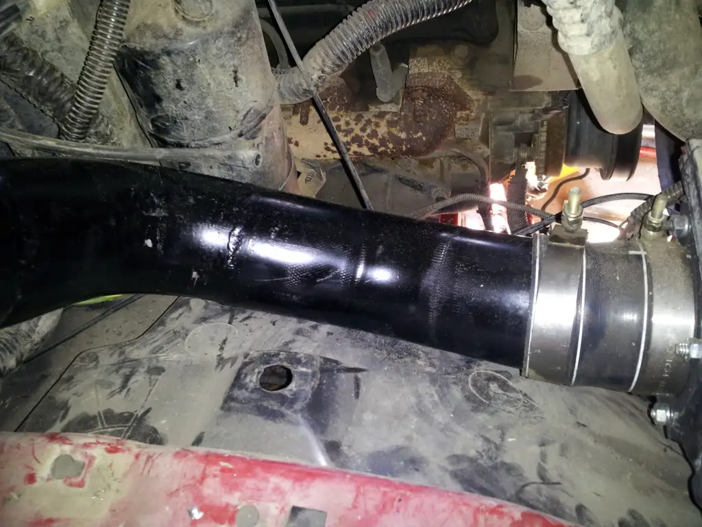

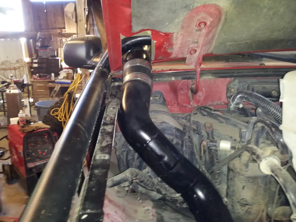

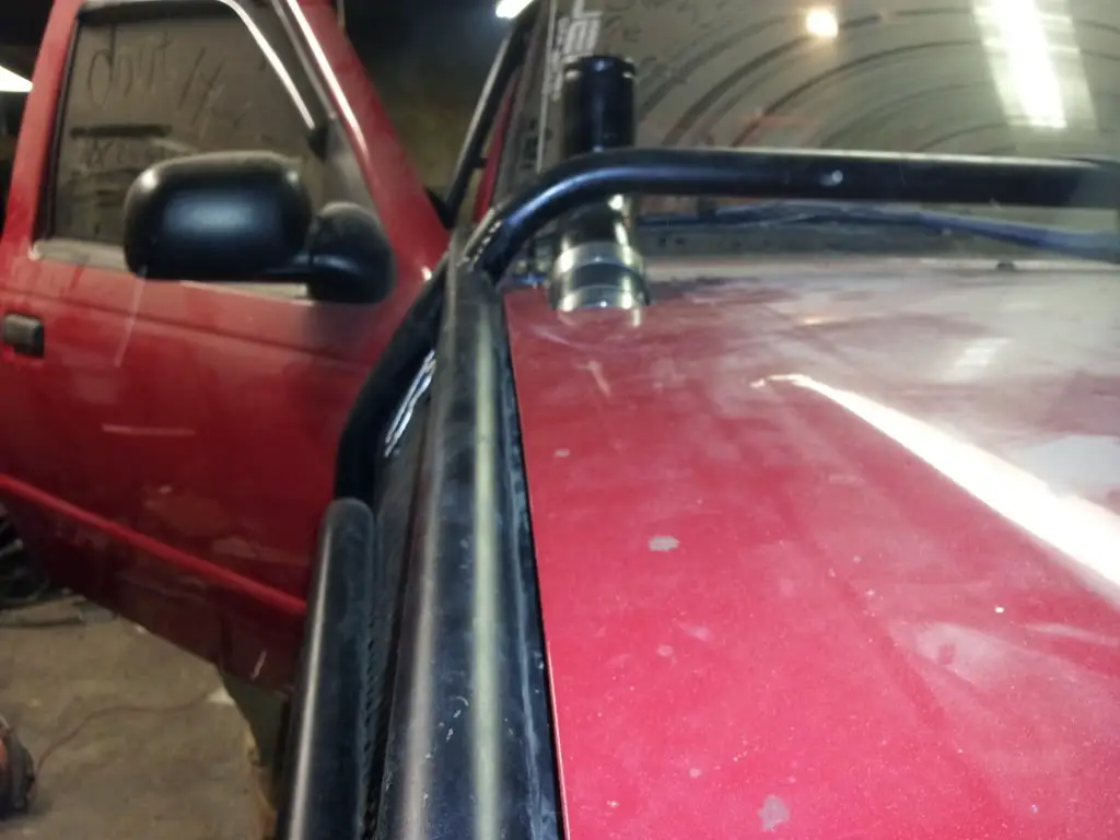

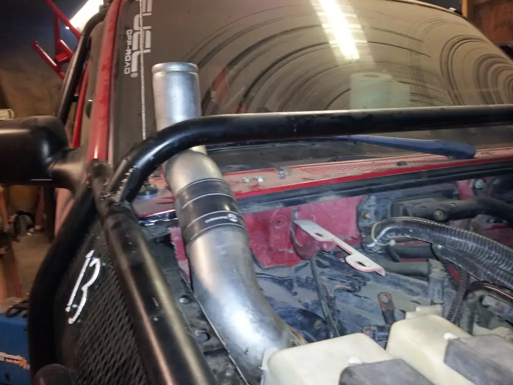

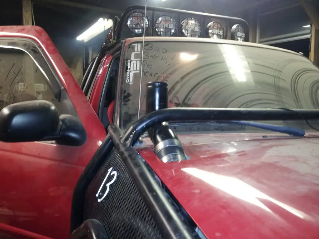

I wanted to fire the beast up so i started on finishing the snorkel..
It worked out really well and i was able to re-use the factory Coolant and washer jugs(i had to cut the mounting tabs off of both and invert the assembly 90 degrees, but it fits!)
Anyone with a Ford Powerstroke might recognize the tubing used as it is a combination of cut intercooler tubes from the PSD's(when i worked as a Ford diesel tech, there was a recall on the plastic version of these for cracking, but they had us replace the Recalled metal ones when they leaked so i collected about 60 of these and have been building CAI's and exhaust with them ever since!)

im not doggin you, but why a snorkel? do you think you will be crossing that deep of water all the time?
its just that most people that have them seem to think all you need to do is install a snorkel and your good. they seem to forget all the other things that dont play well with water.
have you addressed these issues at all? ie fuel filler, computer, fan shroud, and so on?
Looking great and all, but the one big question in my mind is, how the hell will you be able to get the spare down from way up there?? When the truck is sitting on the 40s, the spare's gonna be about 7 feet high, no?

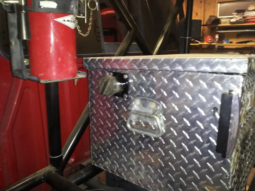

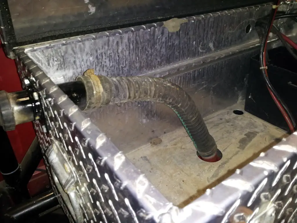

Yes, pretty much all electrical accessories have been tended to and sealed. im running an electric fan as well which is switched power as i dont need to run it very often. only when the truck is sitting idle. The fuel filler neck due the fuel cell right under my toolbox, goes through the bottom of the toolbox and comes out at the top driverside of the toolbox. the filler neck input sits right at rear window level. all vents and other hoses have been routed accordingly into the toolbox as well which is sealed. i never plan on haveing the truck in that high of water, as most people never do. but i have had the truck to the windows in a pond with the factory air setup and drownded it. its mainly an extra precaution as well as to keep the inlet away from mud and dirt because the factory inlet sucks! in the picture of the box you can see it has been full of mud and dirt before.
Its not a big deal for me, im 6'1" and i threw the spare up there myself, getting it off is easier because you can just let it go!(im gonna catch hell for the way that came out...) now if i go any bigger, im gonna have to think about it...
New update.. Its hard to share pictures of every little thing that is being done to the truck on a daily basis... i try to keep pics towards the bigger picture stuff...
got the snorkel complete and the hood notched and back on..
i finally got the entire truck re-wired.. all the lights, gauges, amps, winches, speakers, navigation unit, fuel system and everything else electrical is done...
also threw on some 6.5" wakeboard tower speakers for field parties.. they are on their own amp that is switched so i can turn them off whenever. i also built a second switch in the control box for the sub amp so i can listen to music on the trails without a huge thump...
i also finished the fuel filler neck through the toolbox like i wanted to.. it worked out very well and places the filler neck high up and out of the way of water and what not.. i have an 88 El-Camino out back storing for a friend and i used the factory filler neck off it modified with some fuel hose off the 76 f150 out front.. i had to make a plate to mount the filler neck to the fuel cell..

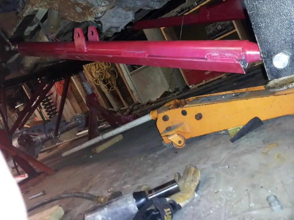

more to come.. other little things are being done everyday but i dont take pictures of everything.. i installed a flip start button in the switch panel that has a secondary switch attached elsewhere. you must turn on the secondary switch before the starter switch will work.. i can give anyone the keys to the truck and they can never start it!!! i also removed the crappy Artec industry rear 4 link lower crossmember as it sat to low! i have since built one more to my liking based off "RookieShooters" bronco 1 and a half. i will post a pic when i get it welded in this afternoon.
