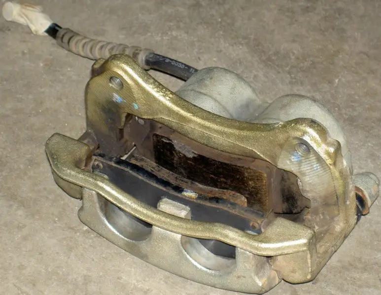

By that, the fronts should be pads for phenolic pistons, and the rear pads are the only question. I have a spare pair of calipers that I got with the 4WD spindles I put on my 99. I don't recall what pistons they were, but I thought they were from a Sport Trac(JY said). This is the only picture I have of it, thought it might not have pads in it.
