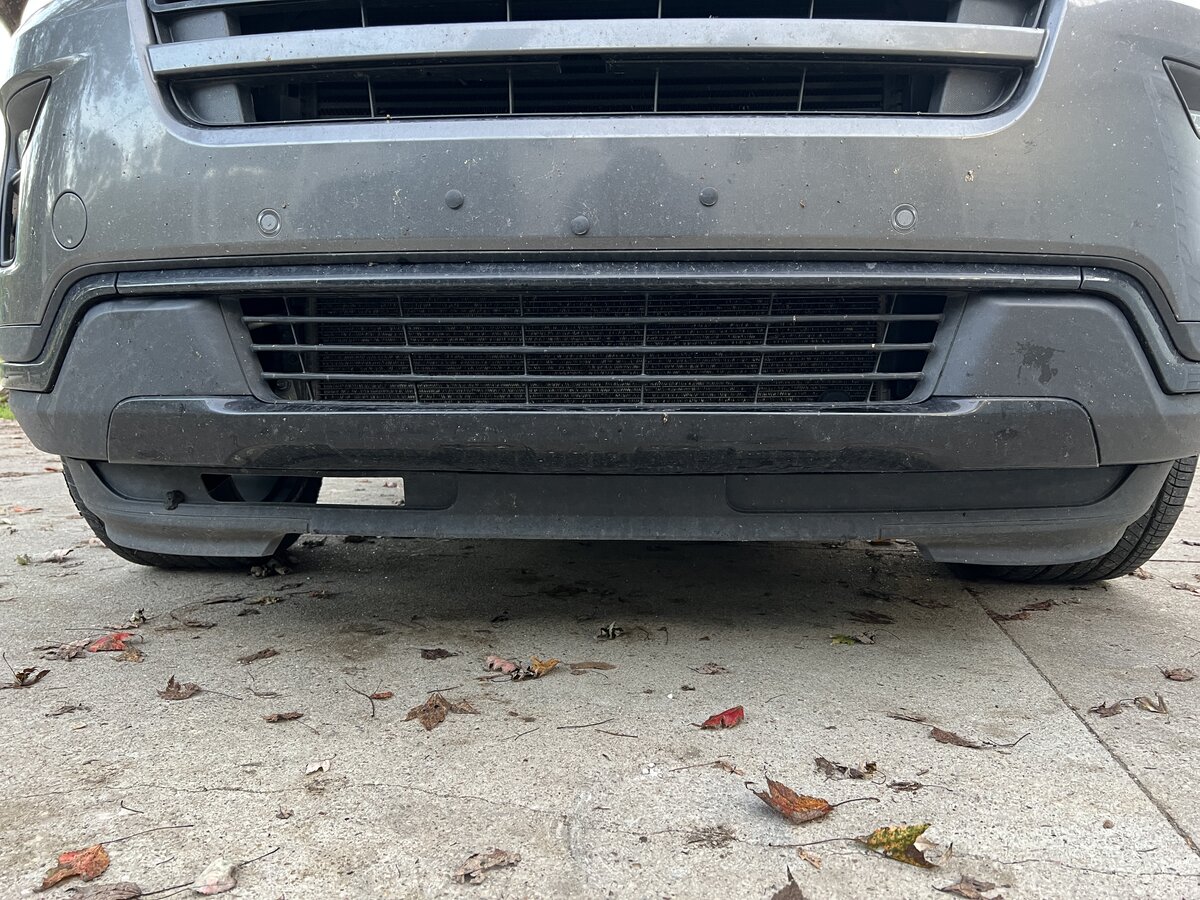

I’ve attached a picture of the valance, I’m not familiar with the scoop

It would seem that you are missing the air intake deflector that helps to cool the PTU.

Yeah you are definitely missing the scoop that goes under there to redirect some airflow to the rear turbo and PTU. Not saying this is causing any of the issues but you may have turbo issues on the rear. If you own or purchase an OBDII reader, you should be able to see what kind of boost your turbos are building, if any. This may help point you in the right direction on what needs to be done.
BB5Z-9910494-A is the part number for the scoop on the 16-19 MYs.

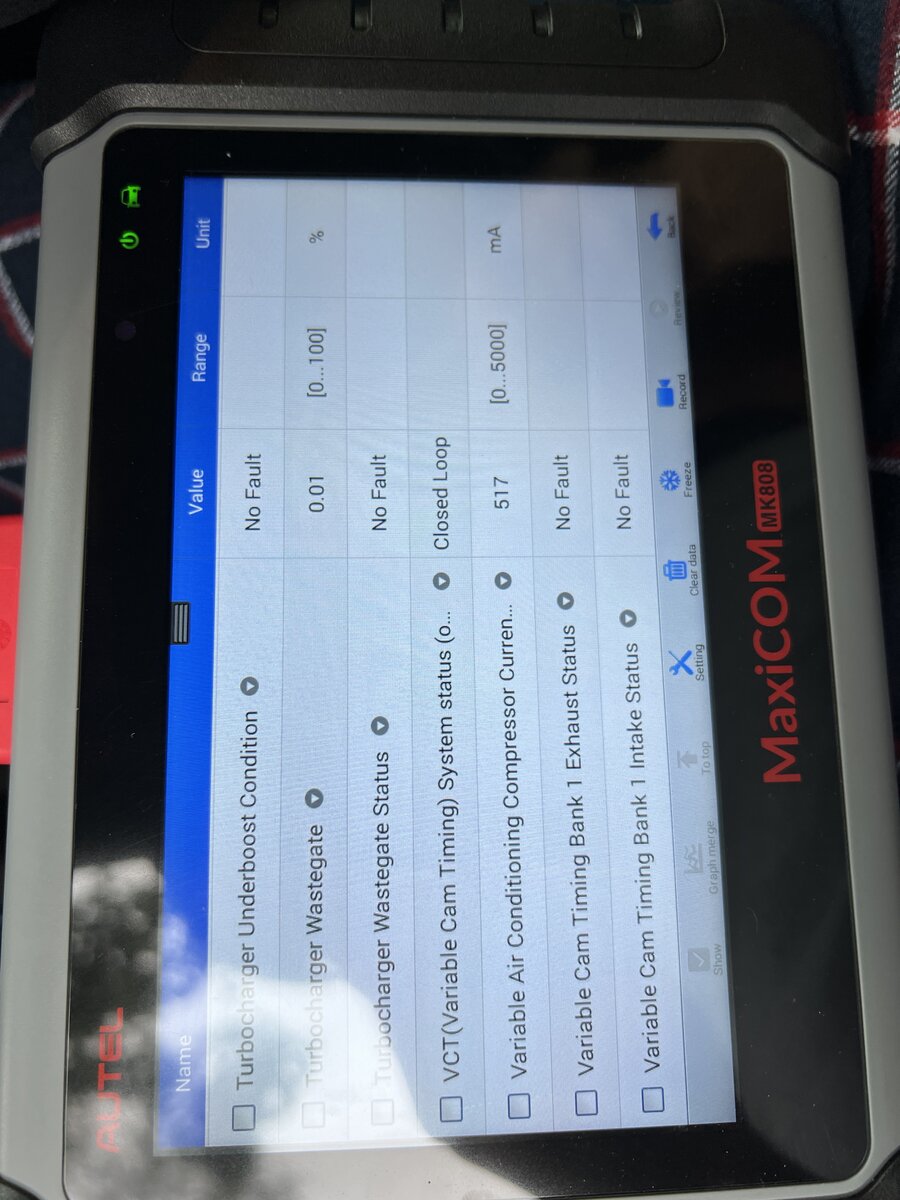

I do have a higher end scan tool. Let me see if I can figure out how to determine the boost

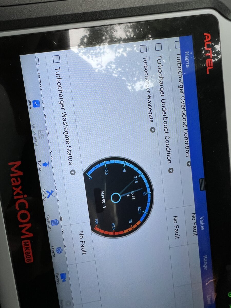

The last photo is showing max wastegate on acceleration in Park.

So your wastegate is maxed out? If so, that's probably why it isn't building any boost.
Can you drive your vehicle while that scanner is plugged in?
At idle it’s only around 0.03%
Yes I can drive while it’s connected.
Not sure how helpful this is. It seems waste gate maxes out pretty quickly.

I'm starting to think you have a turbo failing on you, especially since your mentioned white smoke under hard acceleration and you are missing your duct to cool the rear turbo and PTO. The wastegate maxing out very easily/quickly might be another indicator.
Is there anyway you can monitor your boost levels of your turbos?
That’s my thoughts as well, I’d imagine I can with my scan tool, just trying to figure out how to on it. I reached out to autel hopefully they will get back to me soon, so I can try to check the boost levels.
