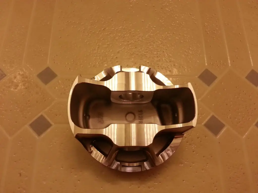

My pistons are in and mannnn do they look good..HUGE comparison from stock to the new JE asymmetrical design. .motor will be hopefully at the machine shop next week...just in time for my BIRTHDAY 11/11 ...;)
Main thrust side
Non thrust side...
You can really see the asymmetrical design here..

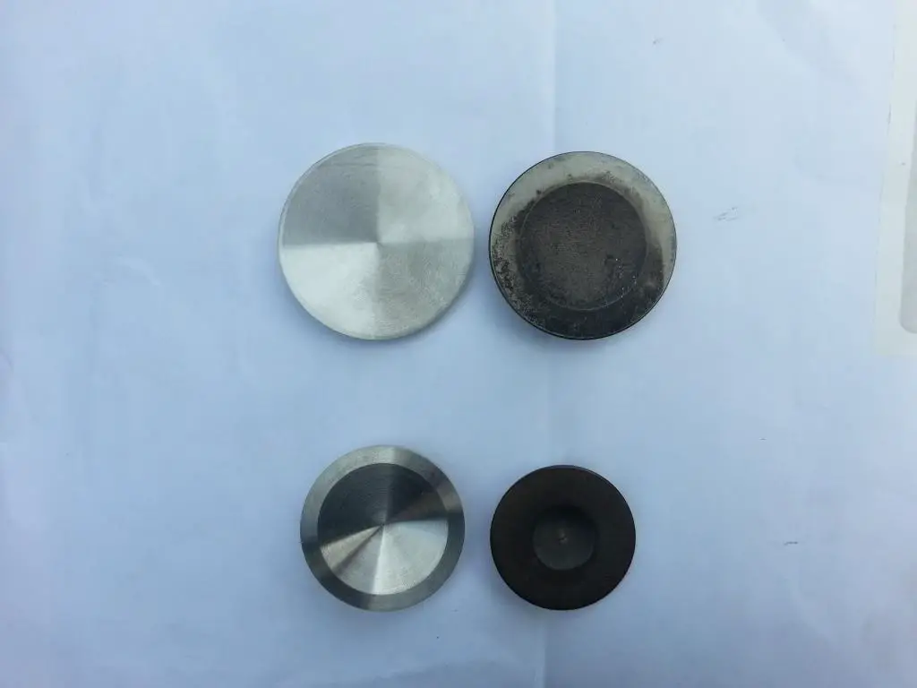

And gonna throw the comparison of rods and valves here also so its all in one post..
you have a scale to compare weight new/old piston? Those new valves look massive compared to stockers.
Yes..I scaled the old ones today with rings and pin.it weighed 1.550 pounds..I have not scaled the new ones yet but I would say they will be just slightly less.the new piston is very thick in some spots and is a larger piston. The pictures make the stock one seem much larger overall than what it really is..I would almost bet the weight savings will come from the pin and not much from piston..the new pin is much smaller OD and shorter..ill post as soon as I have a chance to get to my shop..
I just looked and the weight is on all the new items..the new piston with pin and rings weighs 1.155 pounds or 524 grams...old was 1.550 pounds or 703 grams..so new piston setup is 179 grams LIGHTER ;)
